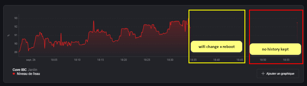

From Homey Insight, history in nor recorded.
Below an example with values from “public” network and after changing wifi to a secured LAN :
Only the last entry is recorded without history.

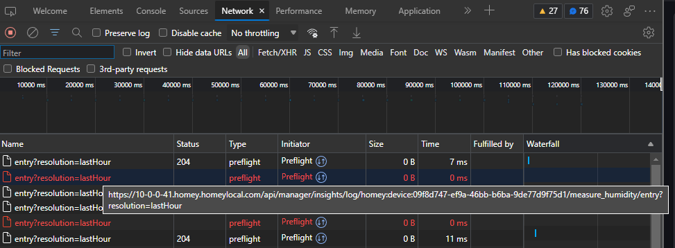

Dev tools console extract :
What are the URL’s for the working (white) and the non-working (red) preflight requests? It doesn’t really make sense that half seem to work and the other half don’t.
Sure, totally agree.
The white URL
The red URL :
I have no idea where to search.
It’s like the order to record data is not able to make the SET.
That’s the same URL, isn’t it? Also, the (regular) xhr request in the top screenshot also seems to be working as well (receiving 31K of data), so that doesn’t really make sense.
No other errors (the MaxListenersExceededWarning isn’t relevant) in console?
