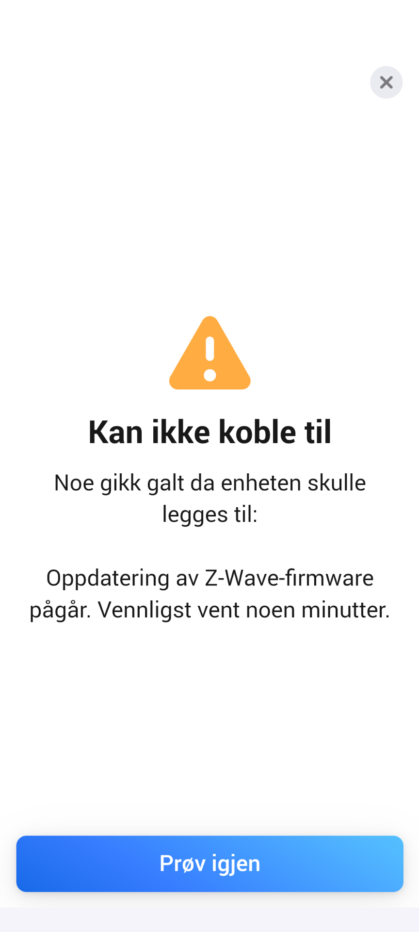

I’v tried several times to add my termostat, but nothing happens and i havt to start over and over.
Tels my to waint some time and try again. see picture
Still no success
Any tips?
Title: “zigbee”
Error screen: “z-wave”…
Can you please correct technical details?
The error msg is odd while Homey is not able update device firmware.
Are you sure you’ve read all z-wave related knowledge base articles?
https://support.homey.app/hc/en-us/search?utf8=✓&query=Z-wave
If that does not help, I’d suggest to create a so called issue here.
You can find such support links at homey.app app pages
It might be Homey’s Z-Wave firmware that’s being updated.
But does updating z-wave firmware happen on the fly, just like that? I’d expect it to be updated along with firmware updates.
(I know, “Thy should not expect” :stuck_out_tongue_winking_eye:).
When updating firmware, Homey is not reachable & managable…
To be more specific: it might be that Homey thinks it’s Z-Wave firmware is being updated, like something got stuck. The code where the error gets thrown is related to that too.
