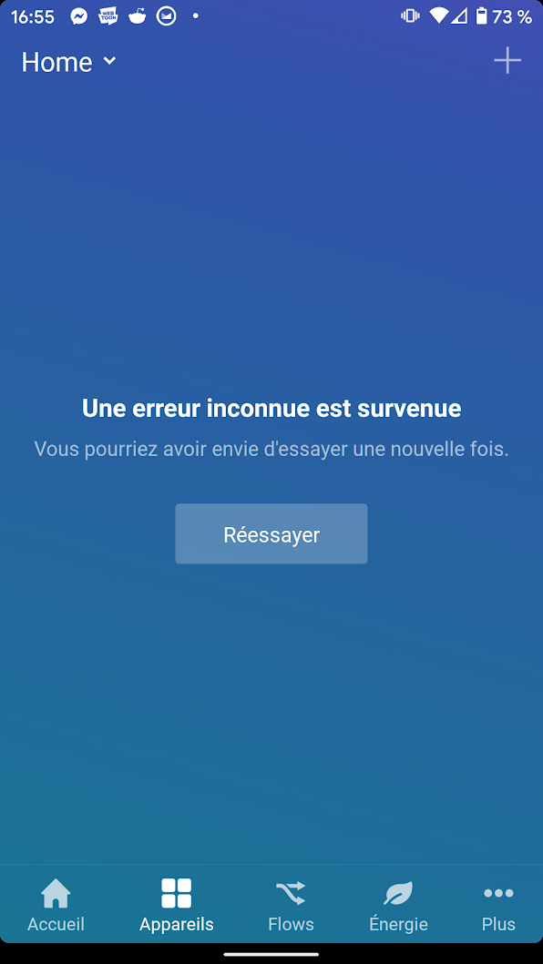

For example, right now here’s what’s going on.
I can turn the lights on and off with a zigbee button so the ZigBee network is working properly. I can also open or close my shutters on the Z-Wave network using the application.
On the other hand, I have a ZigBee light bulb (TraFri) that I can’t add to the network because from the developer console it displays an error and when the error doesn’t display, I have a timeout error. Same thing from my phone.
Is the bulb actually supported by the IKEA app? Also, how many Zigbee devices do you currently have paired with Homey? Homey has a limit of 20 directly connected devices (meaning devices that connect directly to Homey, instead of to a router device in your Homey Zigbee mesh), adding new devices can result in timeouts.
I don’t know if the device is supported by the Ikea App but it should because it appears in the list. But my problem is not about pairing a device (I guess) because this issue is one among others.

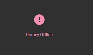

To add some information, I was able to display my ZigBee network from the developer console. I then went to see the Z-Wave network just in case and here is the result:
2020-07-11_17h02_03
It’s unclear to me if you have issues with Zigbee in particular, or Homey in general. Like I said, Homey has known networking issues that cause the app (and the developer console) to say it’s offline even though it isn’t.
If possible, try changing your WiFi router so it uses a fixed WiFi-channel (instead of “automatic”). Also try to pick a (2.4Ghz) WiFi-channel of 6 or higher, otherwise it may interfere with Zigbee.
You mean the fact that the network is indicated as offline is normal behaviour even if it’s online? Will Homey fix this? Seems like I’ve had this problem long enough.

It’s not normal, but it happens to a lot of people, so it is a known problem. I don’t think anyone has ever come up with a definitive answer on why this is happening (mostly because Homey is basically a black box, so you don’t get to see what happens inside).
Homey has just proven itself to be very sensitive to network/WiFi circumstances changing and/or interference. Whereas most devices (even €2 ESP8266’s) have no problems with that, Homey in particular seems to get “lost” very quickly. Sometimes it resolves itself, sometimes you need to reboot Homey to get it to work properly again.
This problem is (or should be) known to Athom because it has existed since firmware v2, which was released about 18 months ago. Either they can’t fix it, or they don’t give it much of a priority. This is one of the reasons why a lot of people reboot their Homey on a daily basis.
