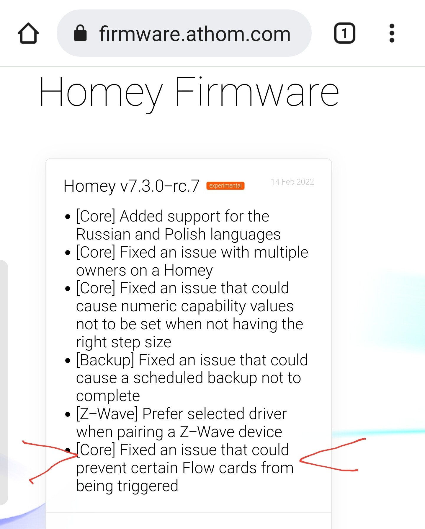

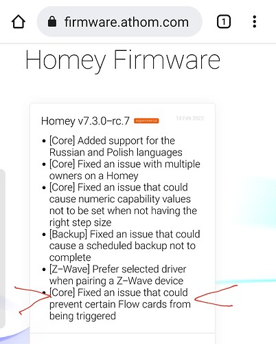

Well, that was pretty quick, there’s a fix.
Installing it atm
It works again :grinning:
