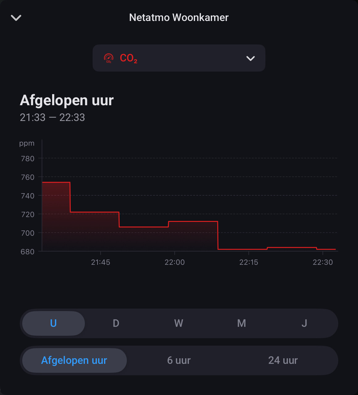

Not an immediate solution, however in my case, on a Homey Pro 2023 with the same official Netatmo app, the values are updates approx every 10 minutes.
Below an example for CO2 values of the last hour.
Maybe the reduced update frequency is related to the cloud version of Homey. However that would be odd, as the Netatmo app is the same and regardless of the type of Homey platform, the data is obtained via the Netatmo cloud connection.
Hope that Athom is able you to help you further.
That wouldn’t be odd, because the Hue app does the same: the Homey Cloud update interval is significantly larger than the Homey Pro update interval (or at least it was last time I checked), because of rate limiting.
