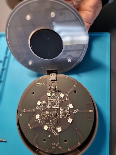

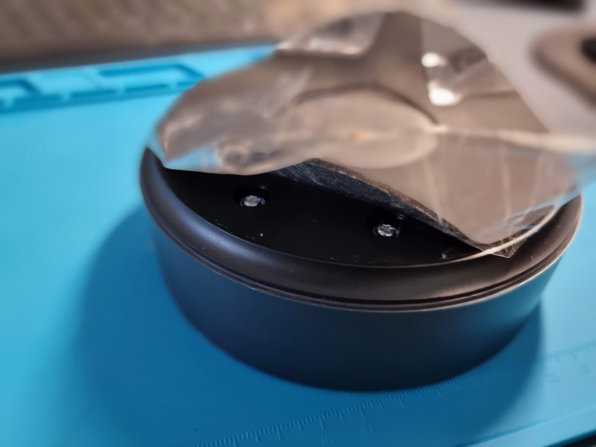

Can PLEASE ANYbody explain me in detail how you got the top lid off the Homey ? Is it difficult? With shat tools ? Risc of braking something??
Red Iphonitis rigorosa : level 11
It is just clicked in, if you gently pry it of with spudger tool or something you should be fine. In the worst case you break one of the clips of the lid😬
Ok.
Thank You Very Much! :pray:t2::pray:t2:
It is also possible to open from the bottom with the 4 screws. Then you can take of the lid and carefully take them apart. No risk of braking anything now. :+1:

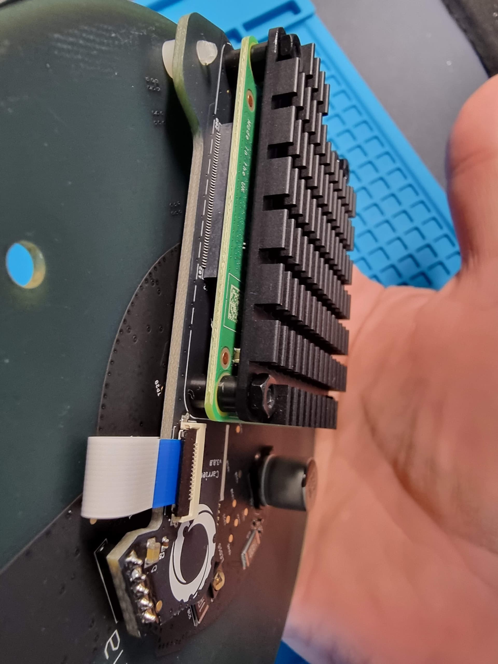

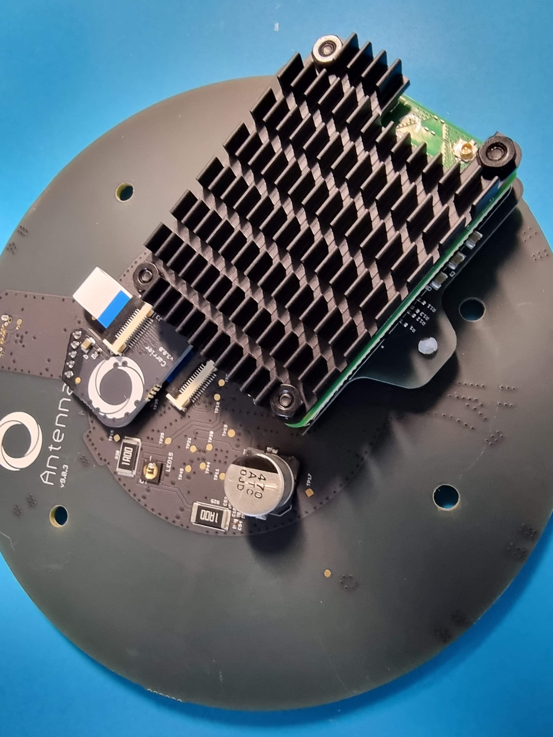

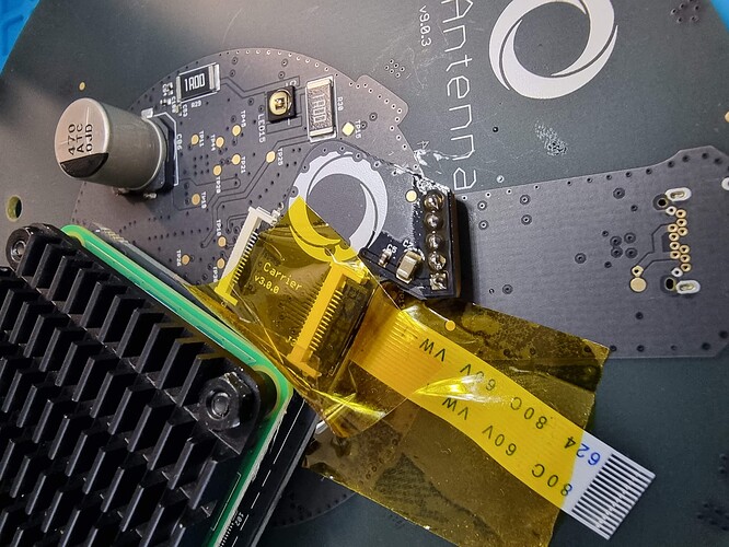

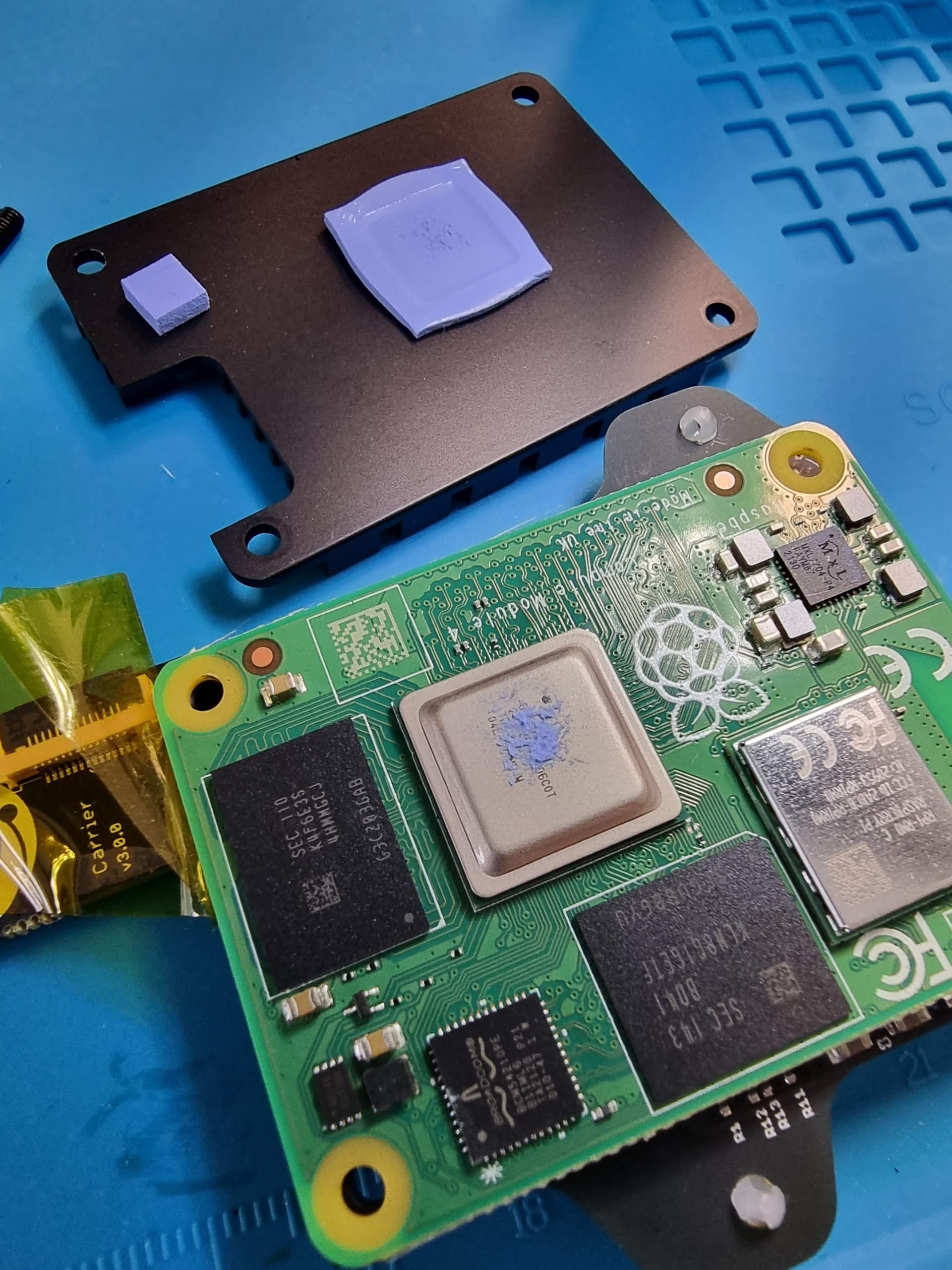

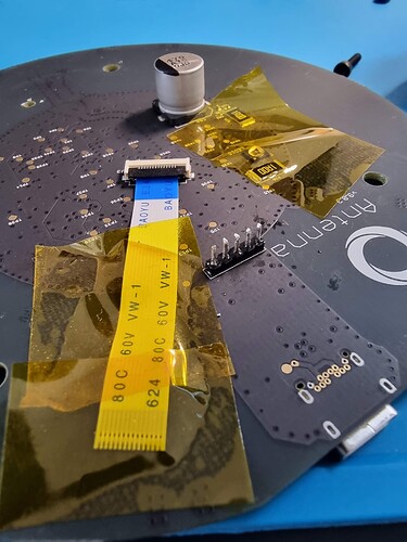

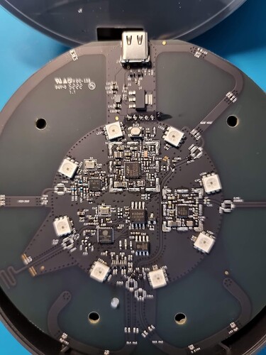

Some additional photos…
For anyone who is interested; I’ve just installed a different heatsink. The temperature (LED off) was stable at 64,5-65,5c before the switch and is now 54c without the LED after the switch.

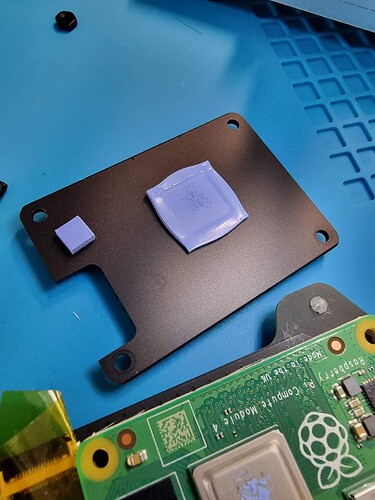

What you need if you want to replace the heatsink:
  1. T8H screwdriver for removing the 4 screws on the bottom of Homey
  2. Wrench size 5 for removing the 4 hex nuts from the heatsink
  3. Thermal pad with thickness of 1mm for the CPU and 3mm for the Ethernet controller (I used 21W/mK)
  4. Heatsink with longer fins. They are 11mm height instead of 5mm. (21gram instead of 11)
I don’t know if I am allowed to share direct links to a shop but you can find them (on AliExpress) and some pictures below could be helpful.
Heatsink (black and blue available):
Thermal pad:
Temperature:
Edit 2023-05-19: When adjusting the nuts (how ‘strong’ they are tightened), you can manage it to lower the temp to ±52c. (room temp 24c):
