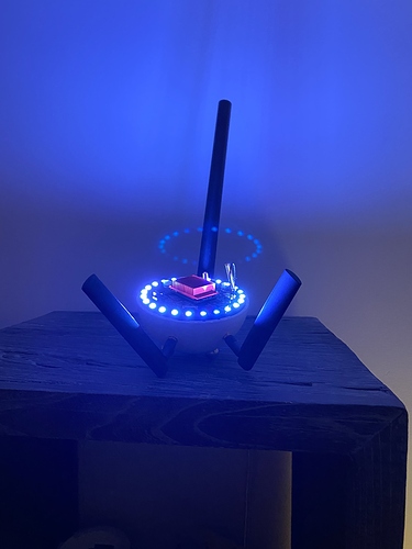

Did my mod finally, opened the Homey by dropping it on the floor, this is how it looks now, still waiting for the new 3D-printed case in black. No more issues with connectivity, I need this mod otherwise my Homey is worthless for a decent house with garden…
The Big Antenna at the back is for Wifi, hoped it picked up 5Ghz, but keeps connecting to 2.4, anyone any suggestions how to push it to use 5Ghz other than renaming my SSID?
No 5GHz unfortunately, only 2.4.

Here is my finnish themed mod, it really improved the diffrent radios.
