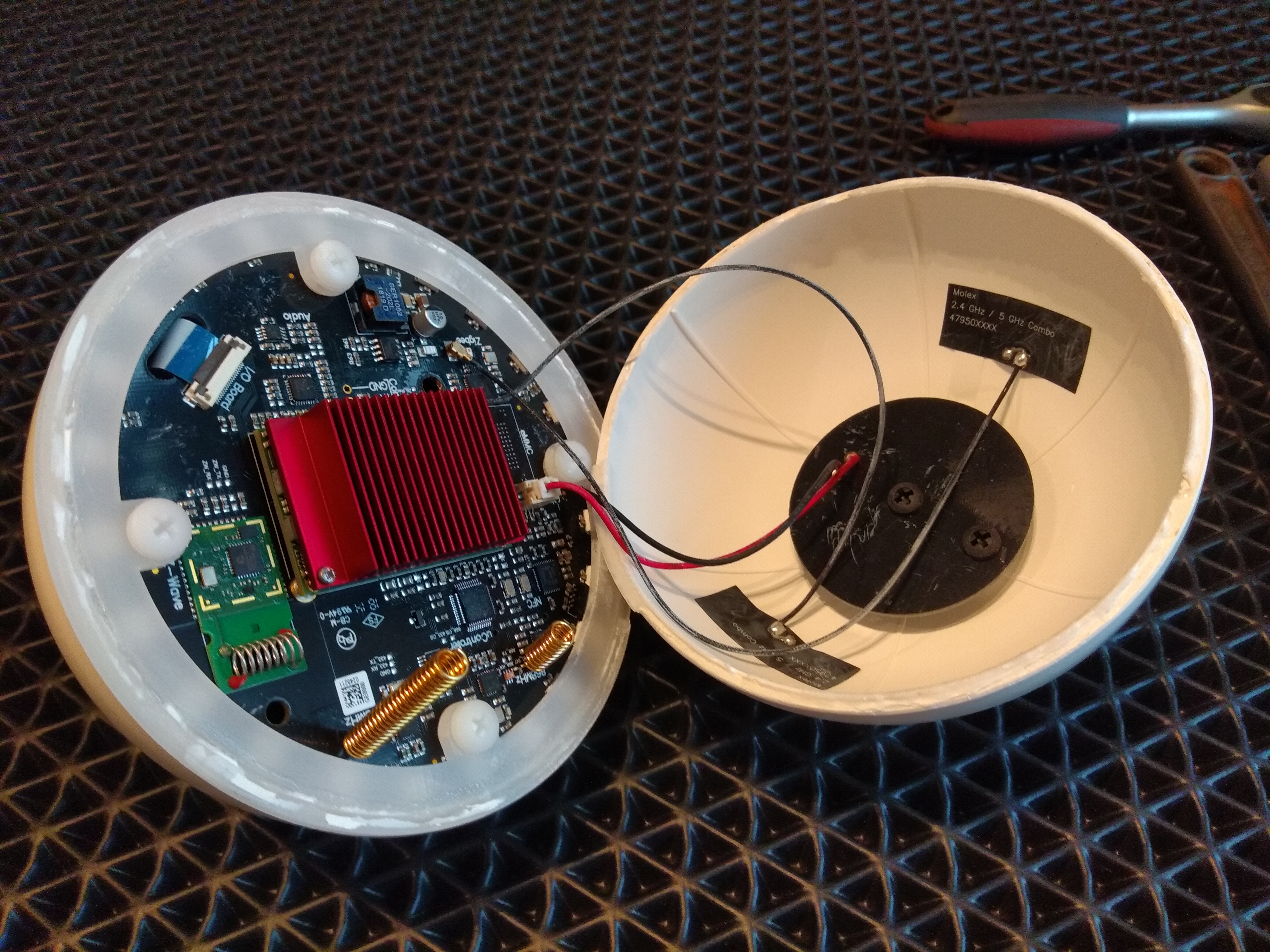

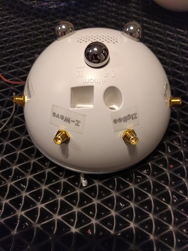

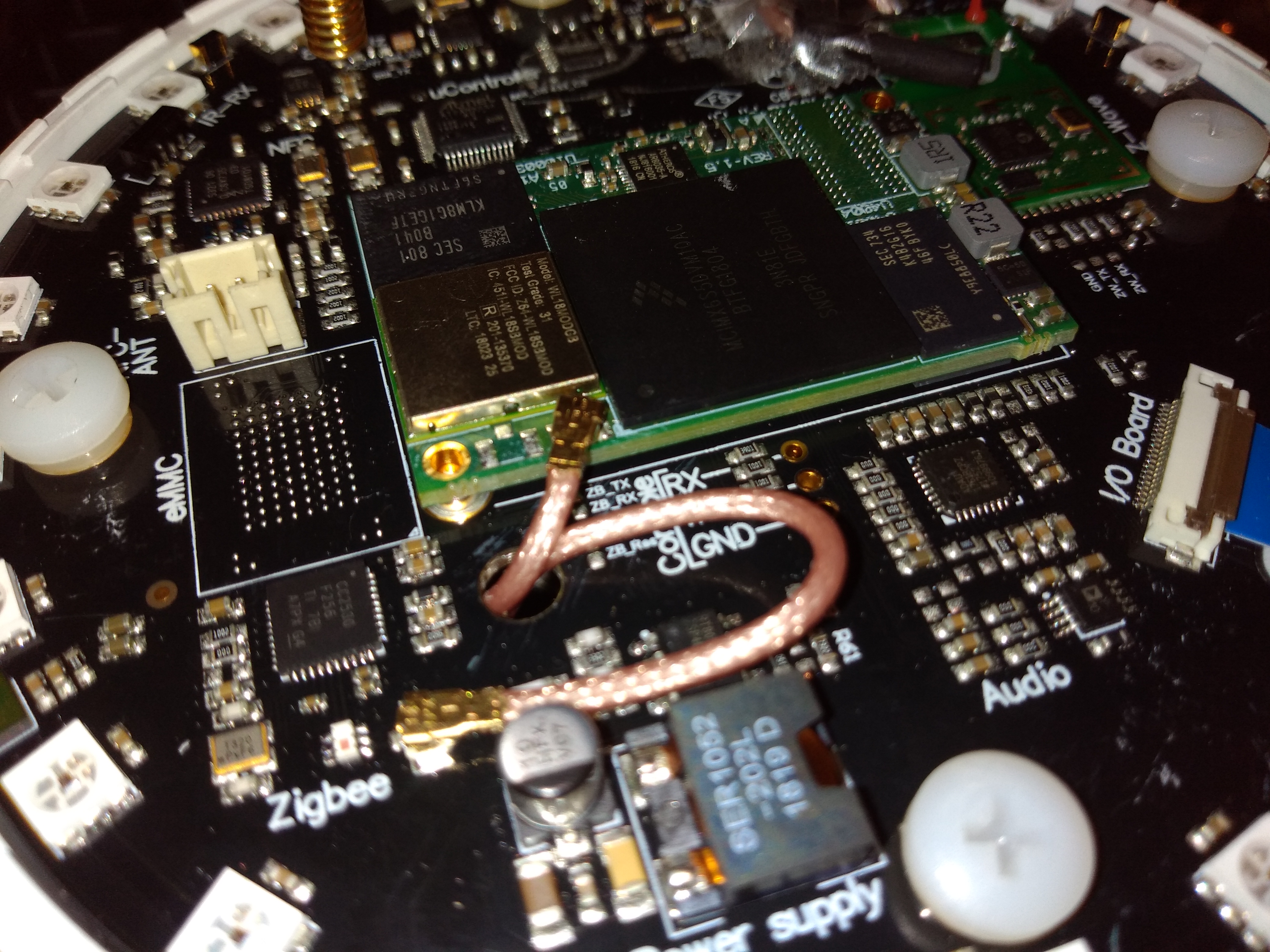

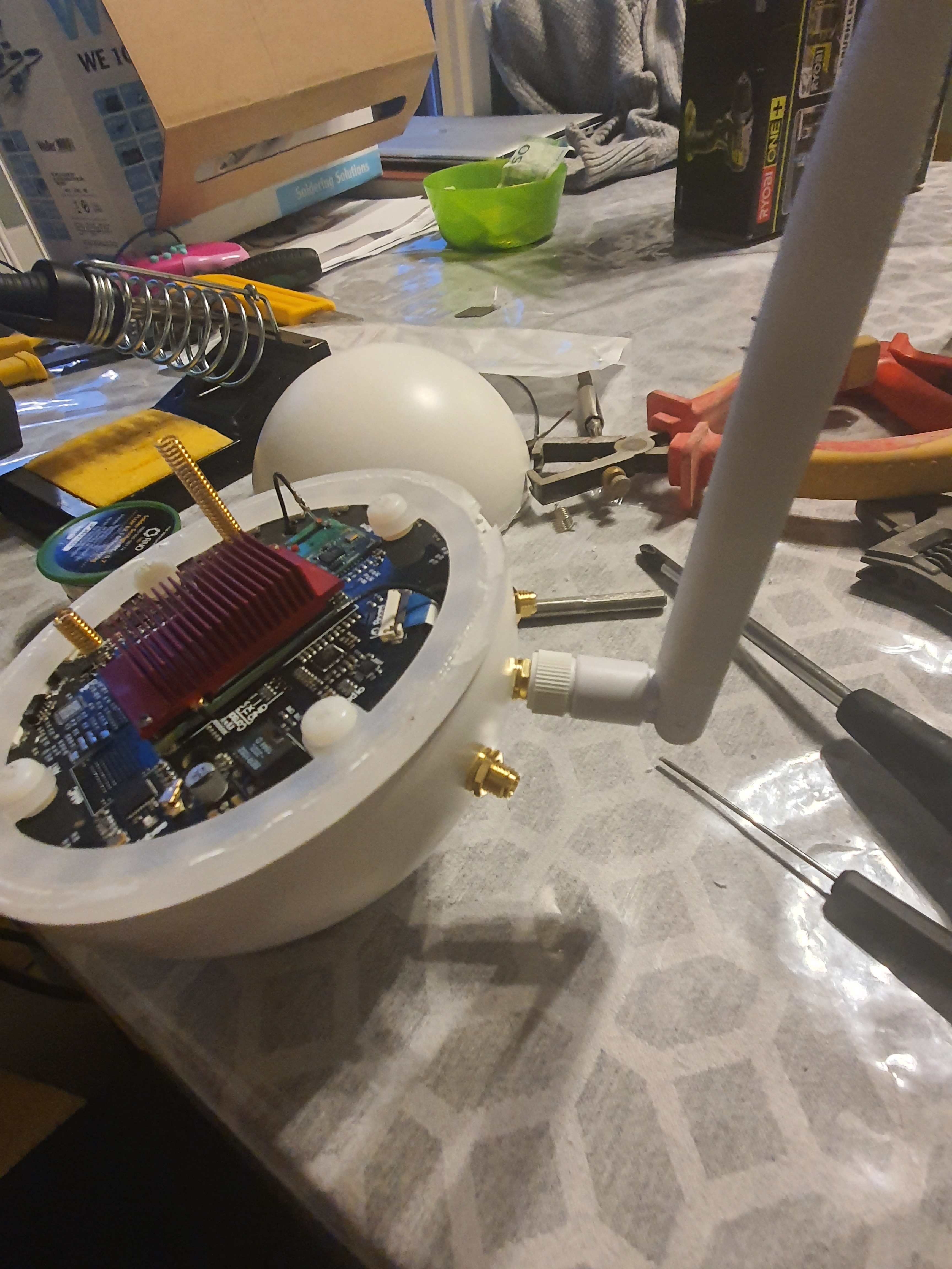

Here are some photos of my antenna mod.
Mount the external antenna for Zigbee, Z-wave, 433Mhz and Wi-Fi
It was very difficult to get up!
Thanks to all who have inspired me!
Bought the stuff here:
https://www.aliexpress.com/store/4770009?spm=a2g0s.9042311.0.0.1f384c4dht91ZZ
https://www.aliexpress.com/store/2663217?spm=a2g0s.9042311.0.0.1f384c4dht91ZZ

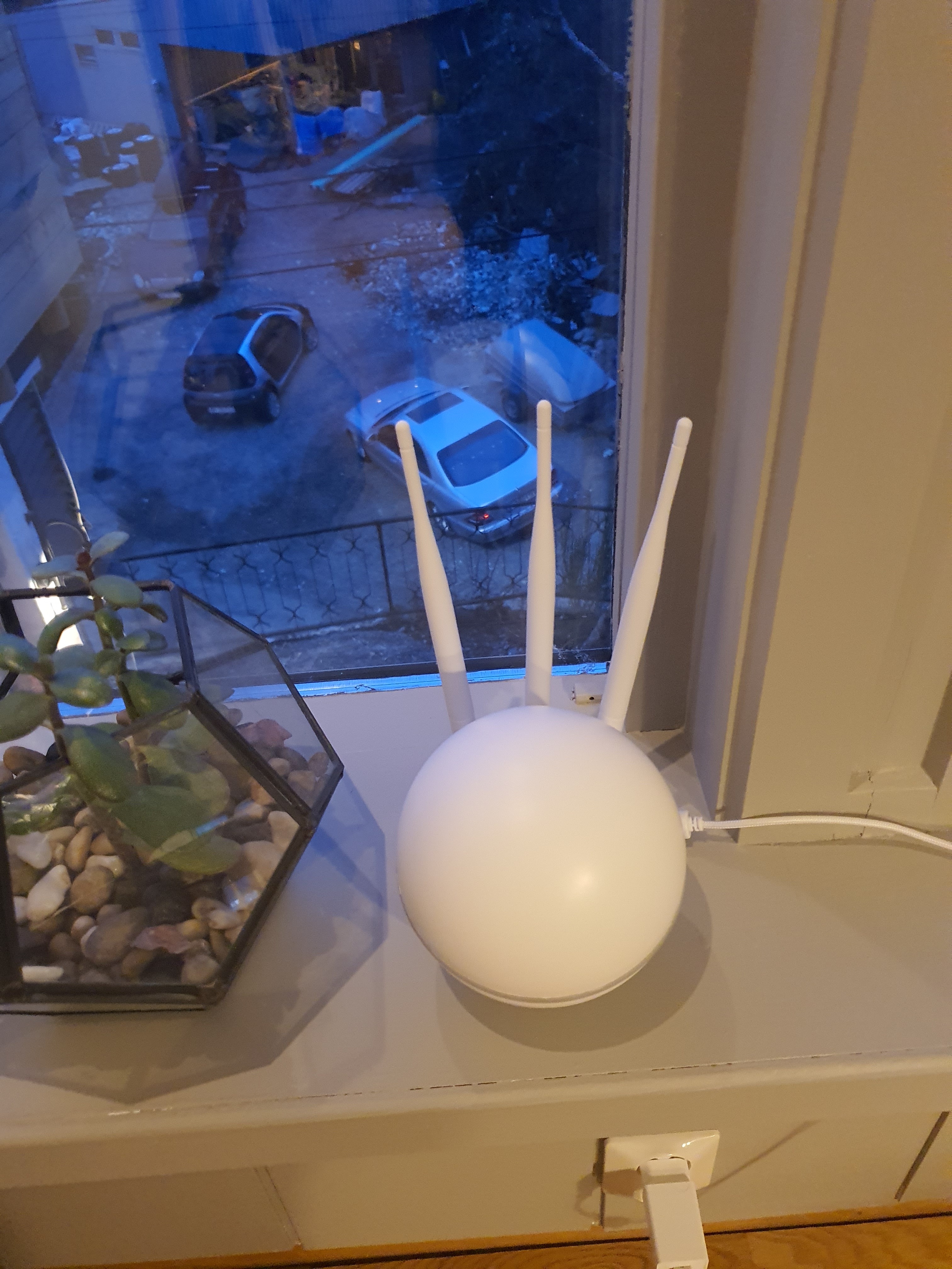

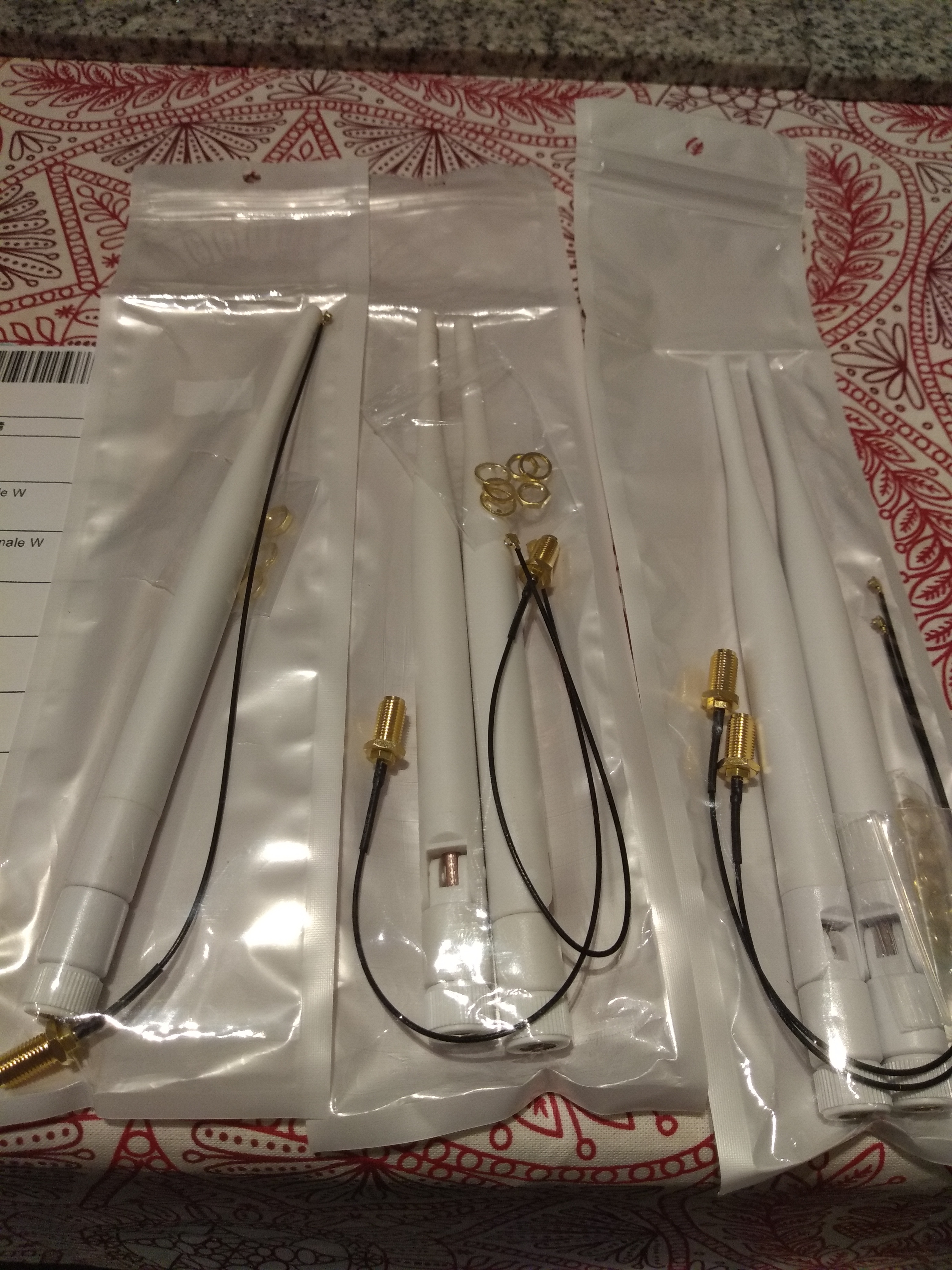

Finally I got the antennas from AliXpress and got straight to work. Z-wave, Zigbee and WiFi. Thank you all for sharing, helped me alot!
And for people not thinking they can do this, it was way easier than it looks.

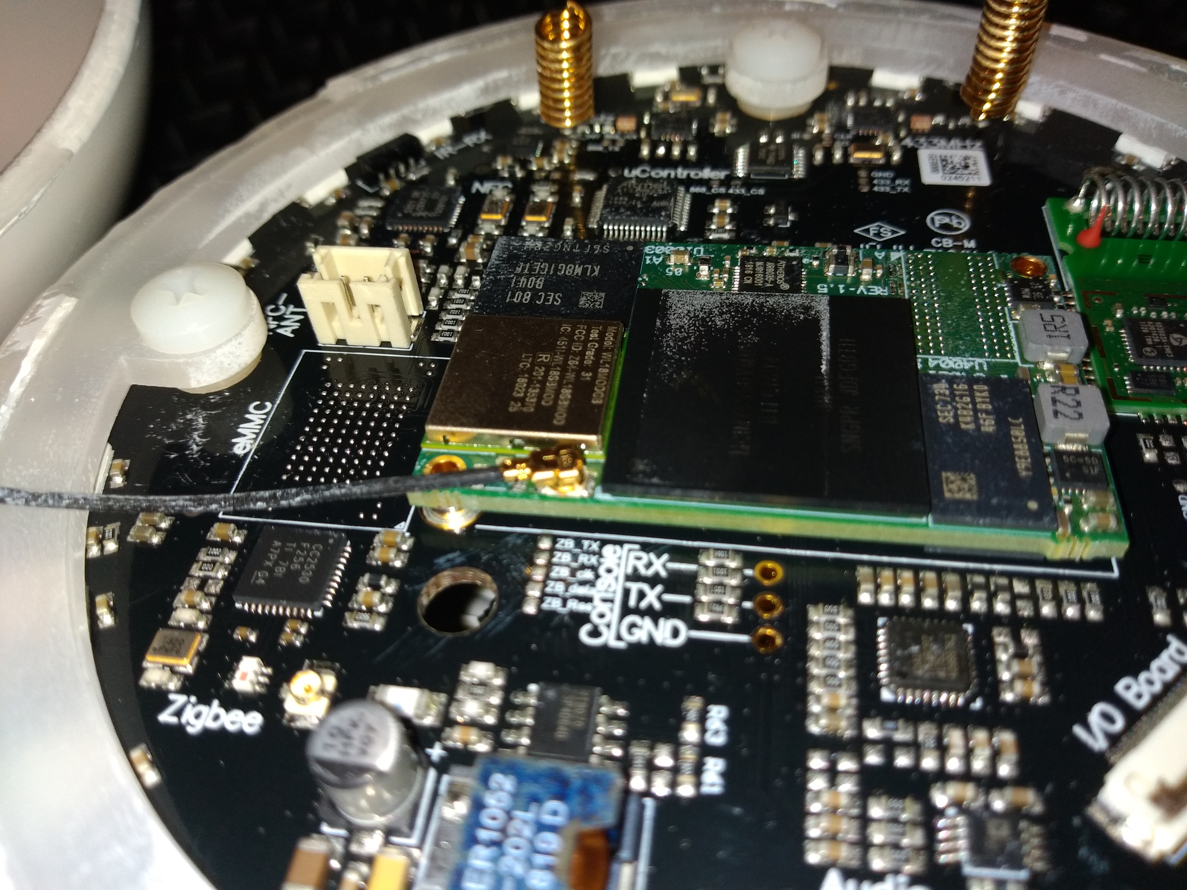

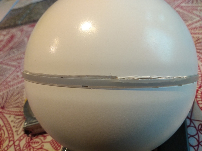

Borrowed a soldering pen from work, and got going with the box cutter. Had trouble with parts of it but got it open in the end.
Got the drill out and started drilling with 6mm drillbit, made the holes pretty close to eachother to fit inbetween the two screw fasteners.

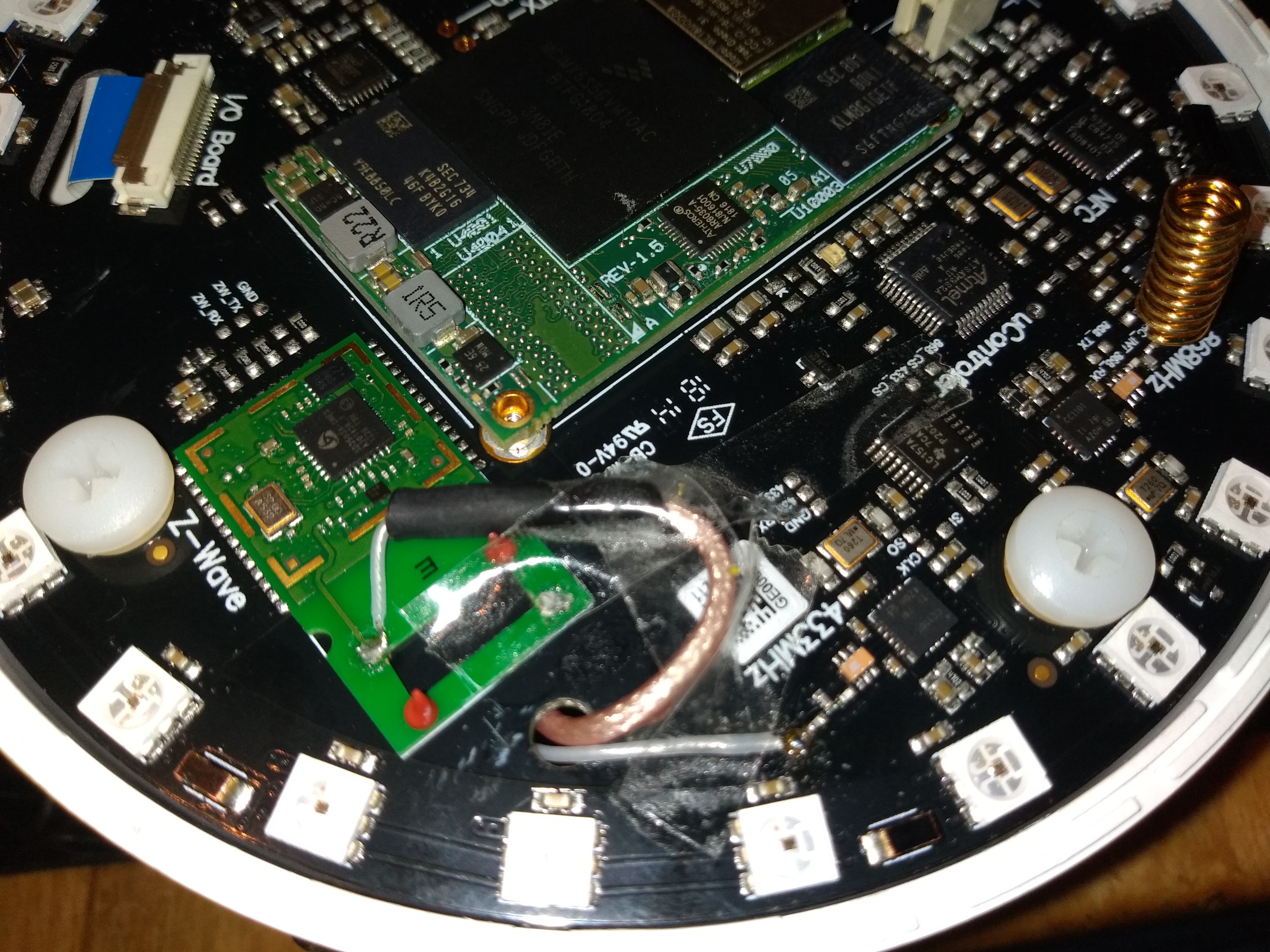

Zigbee and WiFi is just to pop on, while the next job was to solder the Z-wave. Never soldered before, saw a youtube video and got going. Pretty straight forward (and forgiving) so one can’t do too much wrong. I did it the easy what, peeled the protection back and just soldered the pin to the z-wave antenna point (works excellent).
Pretty impressed with my first mod, looks pretty good and works excellent. ID Lock 150 seems happier than ever.

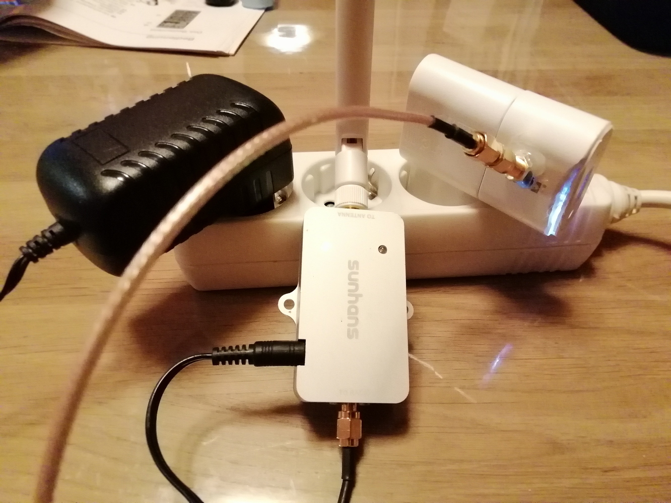

Poor ? The undertaker doesn’t sleep. This is what repeating looks like.
Aeotec Zwave Repeater mod with booster.
Ikea Tradfri Zigbee repeater mod with booster.
For more than one air-to-air connection without walls.
It works great ! Your garden shed would not survive this power :rofl::rofl:.

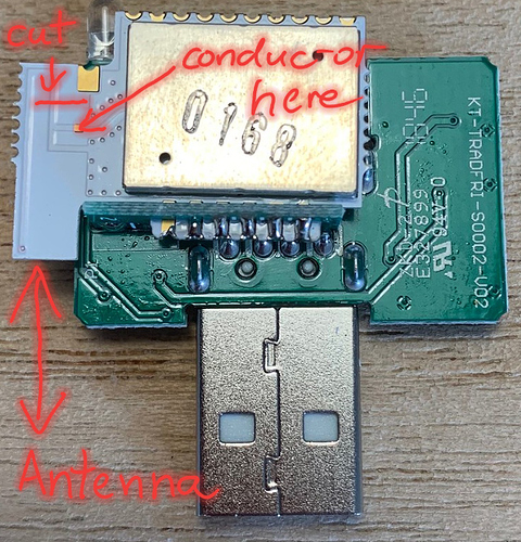

The same procedure at Ikea Tradfri. The housing of the Tradfri cannot be opened without being destroyed. But we are homeys and not beauticians. Boosters can be bought on the Internet. Please pay attention to the correct frequency of the boosters.

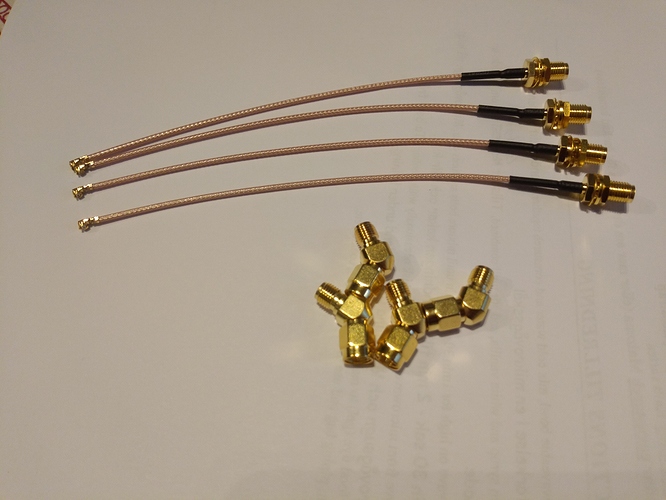

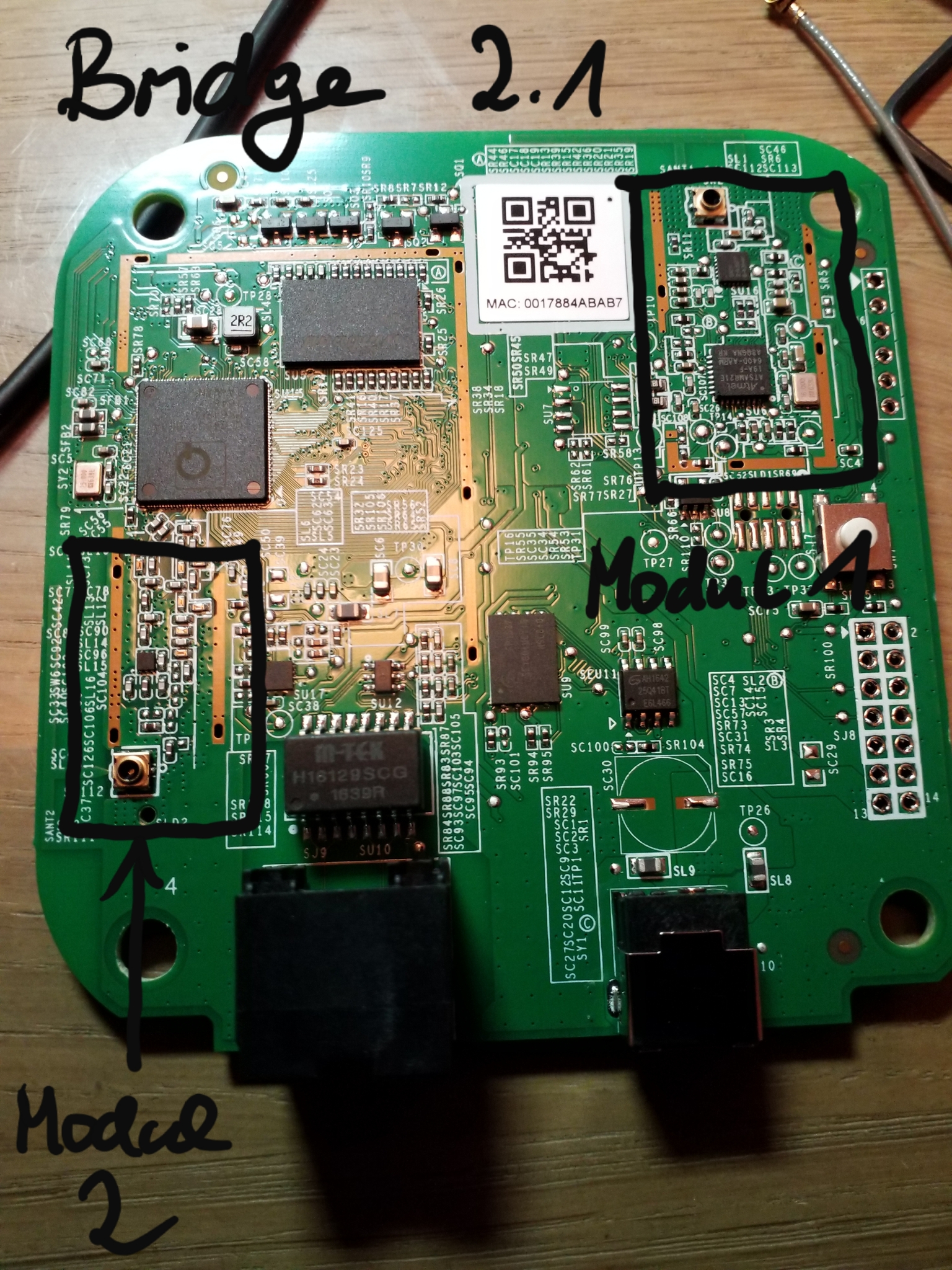

The Ikea Repeater has only one antenna. You get a pigtail like this one.
images
The pigtail has a conductor and ground. The conductor is soldered to the antenna and ground to any point. If you want, you can now interrupt the original antenna. You can connect everything else to the pigtail. if you work with a booster please consider that this service is not allowed in many countries. It is important to use antennas or boosters with the correct frequency. Please do not use amplifiers with more than 1 watt power. You don’t want to supply your entire city.
Zigbee 2.4 GHz
Zwave 868.42 MHz.
This also works with the Hue Bridge:

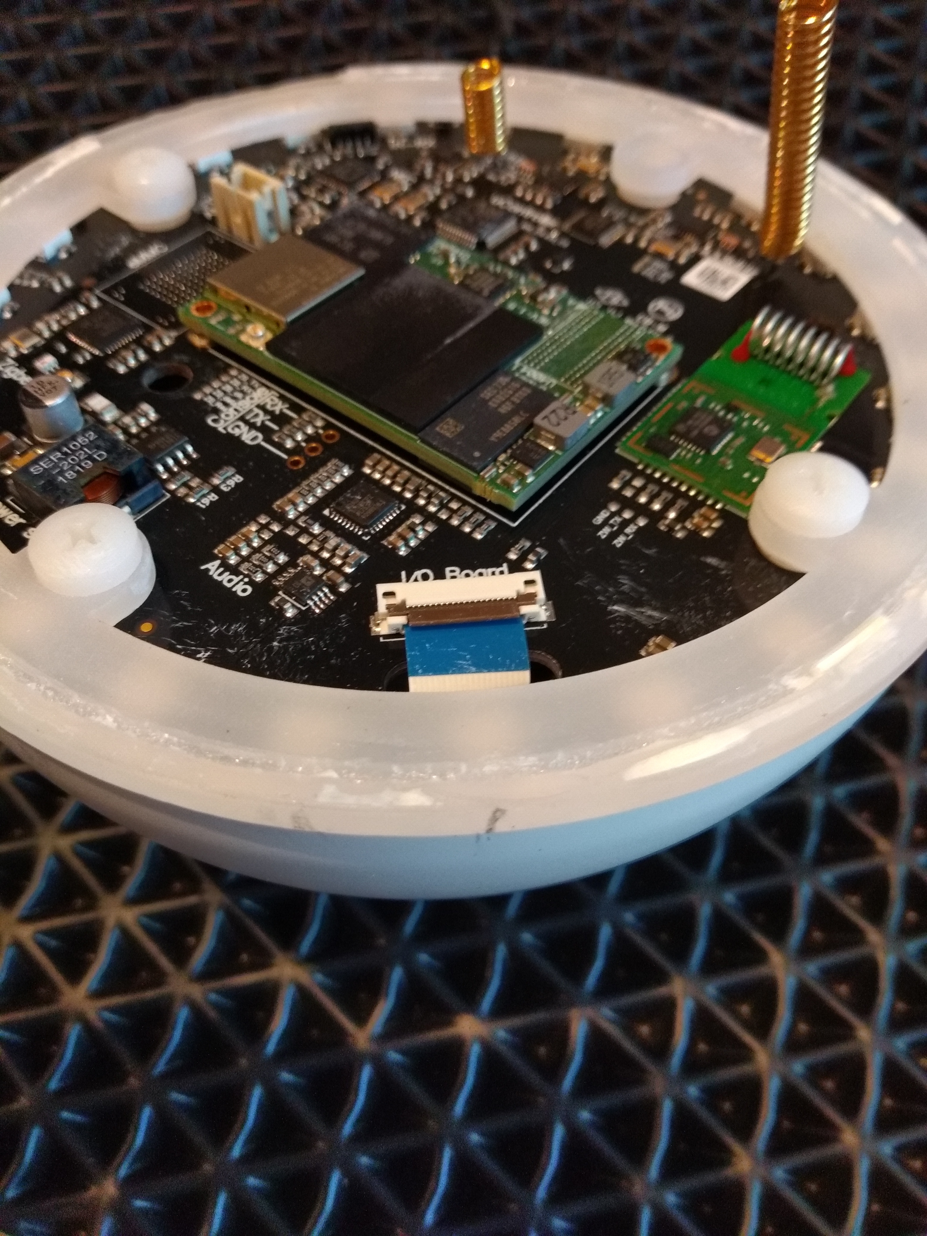

I have modded my Homey (1st gen) some time ago too.
With Wifi, 433MHz, Z-Wave and Zigbee antenna’s.
Looks and works great!
And it came out fully undamaged (when opening).
