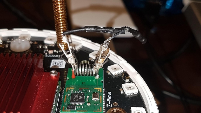

First of all, openining Homey was quite unexpected for me… accidentally I dropped Homey on the floow, two screws keeping top and bottom half of the dome got broken, and since I heard something rattling inside I decided to break other screws. The thing rattling inside was remaining of the screws, fortunatelly everything was working fine - and I had my Homey open.
Then the antennas…zigbee was easy, the connector on the motherboard makes it easy as a piece of case.
Then the z-wave. Well I’m far from being a soldering master, I really wanted something that will not require manipulating soldering iron inside Homey. And I found these little guys - https://sklep.avt.pl/krokodylek-nieizolowany-mikro-l-17mm-przylacze-lutowane.html (sorry, Polish only, but you can take a look at the photo with dimensions) - micro crocodile connector, small enough to attach to the original z-wave antenna. So the only soldering needed was between the crocodile connector and the antenna, far away from the Homey. Of course to use that you can’t completly remove the original antenna - you should leave at least some remainings to be able to attach these crocodiles to it. I personally decided to leave it at least for now.

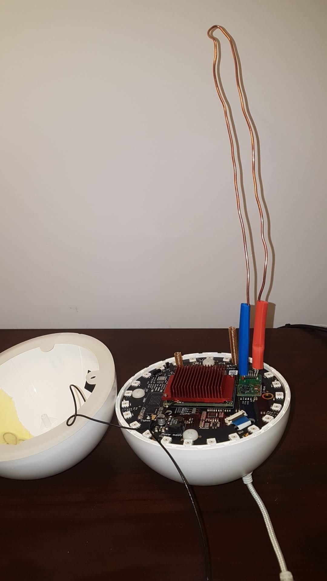

The third part - the z-wave antenna itself. I experimented with two - the beautiful, dedicated antenna designed fot 868 Mhz, and a basic copper wire about 30-40 cm long. Well the copper wire is ugly as hell, but - at least in my setup - it gave better z-wave range then dedicated antenna. Probably because it just much longer.
So far I’m happy with modification, although I’m still experimenting :slight_smile:

These is how crocodile connectors are used to attach a dedicated 868Mhz antenna to the original Homey z-wave antenna
This is my experiment - antenna made of copper wire (I bought a standard electric cable and extracted the coper wire from it)
(the red and blue things on the wire are isolations - I didn’t want the antenna to touch anything inside Homey)
