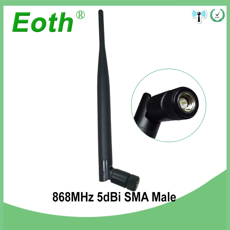

Hi Jonas…
Thansk for swift reply. Im still trying to understand it all. I was going for a z-wave mod with an antenna like this:
But if this can be illegal and interfere, I will wait until we know better. Is there a way to check if its OK do do it? Without buying “strength indicators” and other technical stuff. This is over my head, im just a medium user that wants better z-wave coverage.
