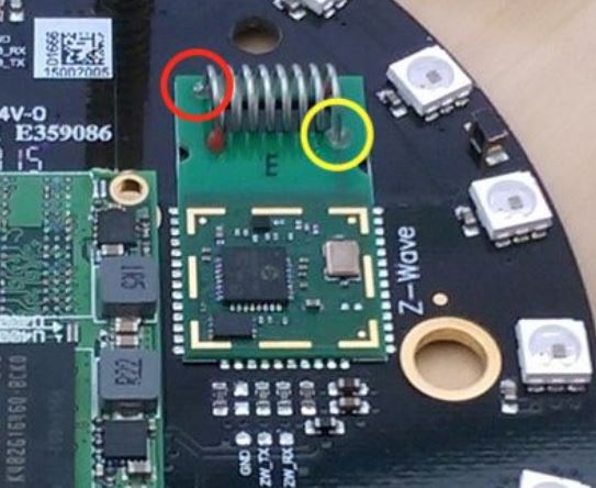

Then I de-soldered the connection in the yellow circle
yellow
Then i soldered the antenna to the board.

It’s been said here before that the B connection is not necessary. But make sure then that B is not touching anything else in the homey. I did it because then the antenna wire was kept more in place, because you will notice that the D wire is a really weak connection. And i wanted to keep the homey antenna in place so that when the external antenna would fail that I could just re-solder the homey antenna back.
