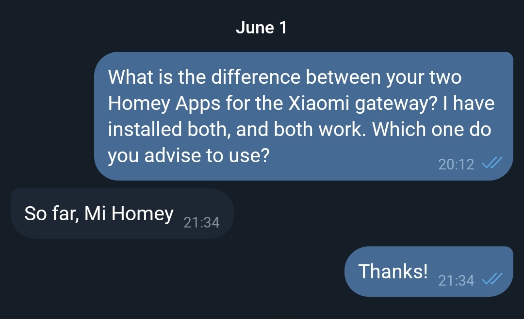

This⌠It is also the only app that gets updates still.
Mi home has not gotten any for the last 5 months
Odd indeed.

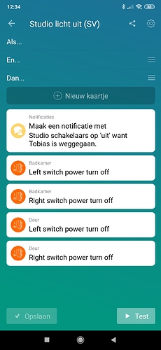

Does anyone use the âAqara double wallswitch with Neutralâ?
I have added it successfully in the App. It shows up correctly as a device. I can use the left and right switch in the App. But, it does not actually do anythingâŚ
So, no errors, but no switching either.

I have a flow to switch them off, but if I run it the flow works (no errors) but the lights stay onâŚ
I use this flow:
When: click single switch
Then: toggle on/off a lights group (2 bulb of dinner table)
This works for my.
I think is not correct. In then must be the bulbs, and not the button.
The device gives me the option to switch it âon/off/toggleâ as action cards.
These do not work (for me). If they donât work at all, they should not be available in the THEN section,

Could you make a new flow and test the following (similar to my flow): in the THEN column put an action card from the switch and make it switch On (or Toggle) the switch that controls a light.
In my case the flow works, the action cards get a âgreen tickâ, but the switch is not actually switched.
