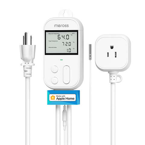

I have the Meross Smart Wi-Fi Socket Thermostat (MTS960):
How can I request/petition for this device to be supported by the Meross app?
