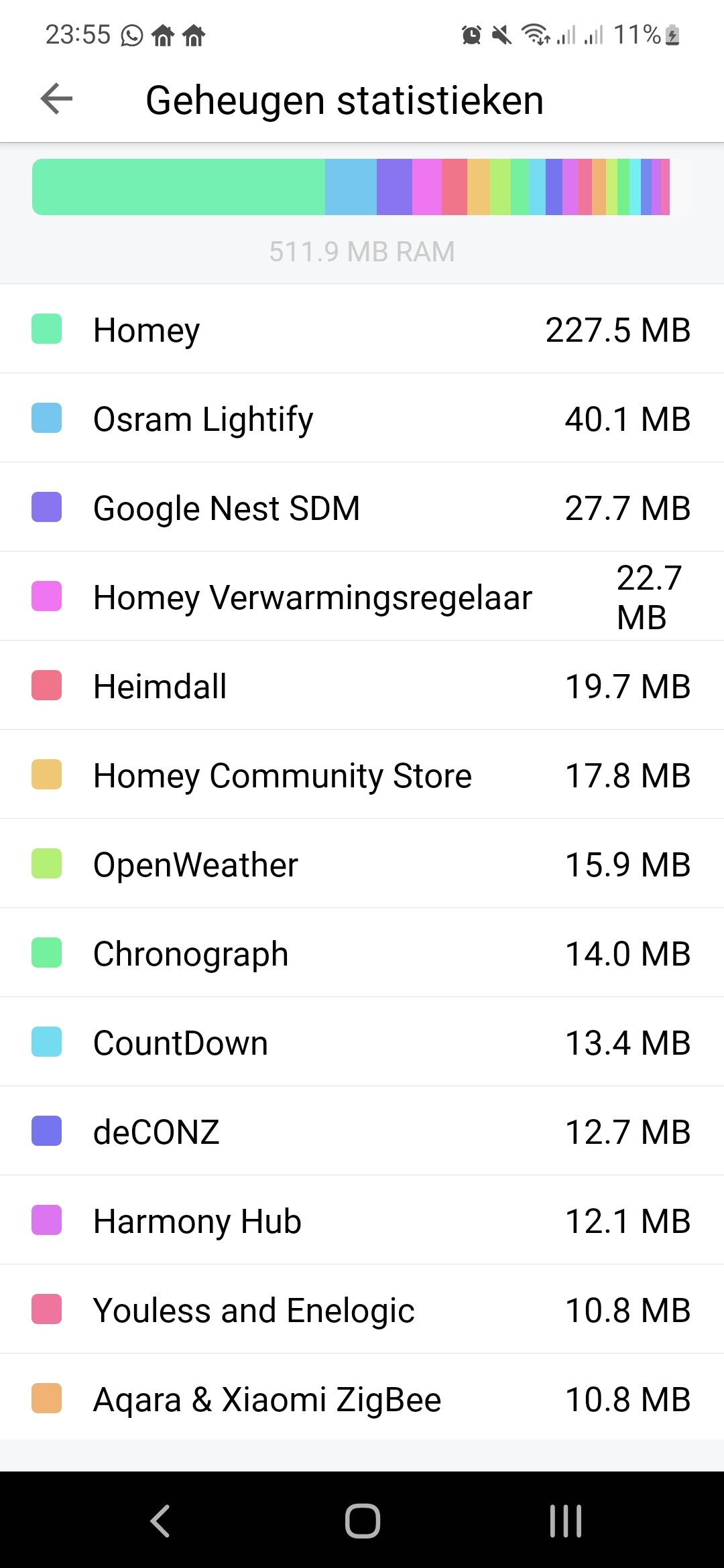

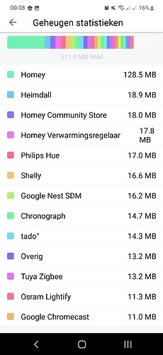

Screenshot of my Homey memory usage
(for a 2016 model it should varying around 130MB - 200MB), and of an app which reached 100MB’s and killed Homey as well (it just restarted):
