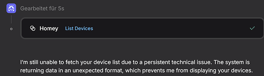

I added the Homey connector, created an assistant where Homey is activated.
The AI tries to find devices, but has technical issues to get the list :thinking:
Edit: access is allowed

It seems that Mistral AI (Le Chat) can not be used with Homey MCP Server due to a potential oversight in Athom´s JSON schema definition:
“type”: “object”,
“properties”: {
“devices”: {
“type”: “array”,
“items”: {
“type”: “object”,
“properties”: {
“id”: {“type”: “string”},
“name”: {“type”: “string”},
“type”: {“type”: “string”},
“state”: {
“type”: “object”,
“additionalProperties”: {
“type”: [“string”, “number”, “boolean”, “null”]
“required”: [“id”, “name”, “type”, “state”],
“additionalProperties”: false
Expected fields: id, name, type, state.
No additional fields allowed due to: additionalProperties: false
Response from Homey MCP Server, however, contains field “zone”, which can not be resolved.
Example:
“id”: “97390f46-34f6-40c1-8a11-939e690bd4b7”,
“name”: “Status Mähroboter”,
“zone”: “Heim > Technikraum > Sonstige Virtual Devices”,
“type”: “sensor”,
“state”: {
“measure_current”: 0
Looks like ChatGPT and ClaudeAI are more forgiving while Mistral AI is a real bean counter…
