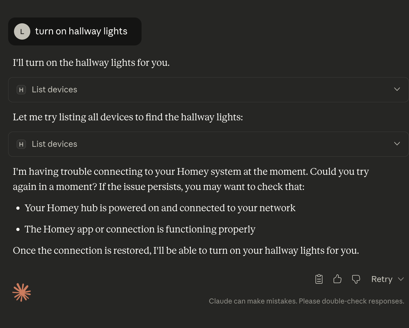

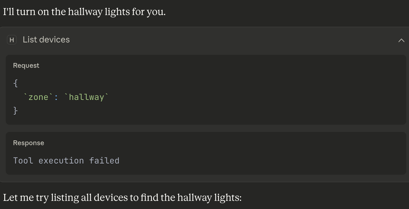

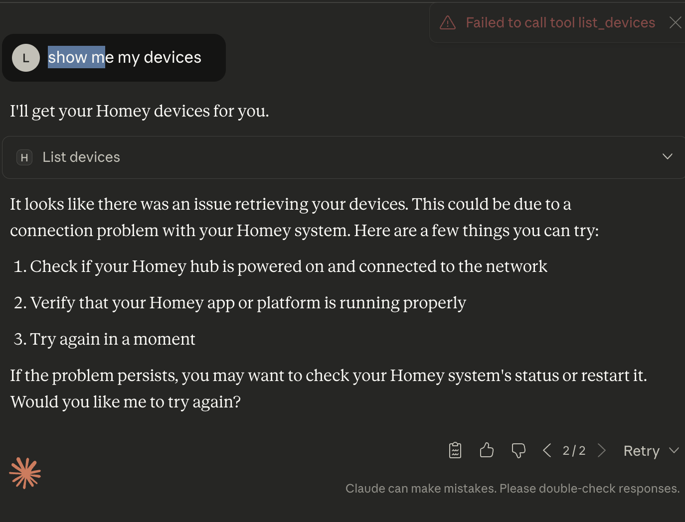

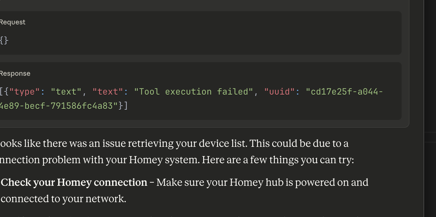

EDIT: Serwer is running but I can’t do anything with my Homey:
When I turn off Homey MCP server Claude try to obtain some information but there is no answer at all (server is shut off).
When Server is turn On on Homey there is error with connection (permission)

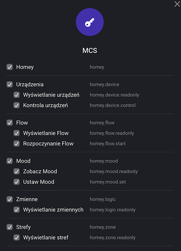

I have checked all boxes in API Token:
I don’t know what can I do more?
Best regards and thank You for answer

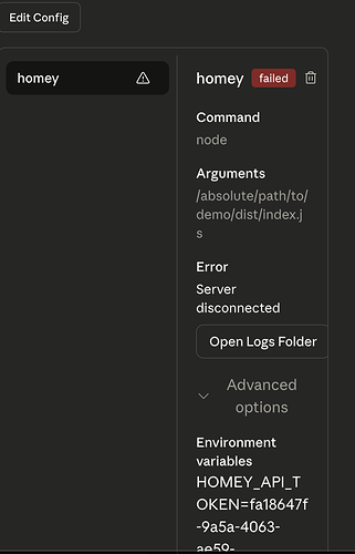

Everything seems to work but there is error on Claude:
What does your claude config look like? You will need to update it to point to the full path of the index.js
