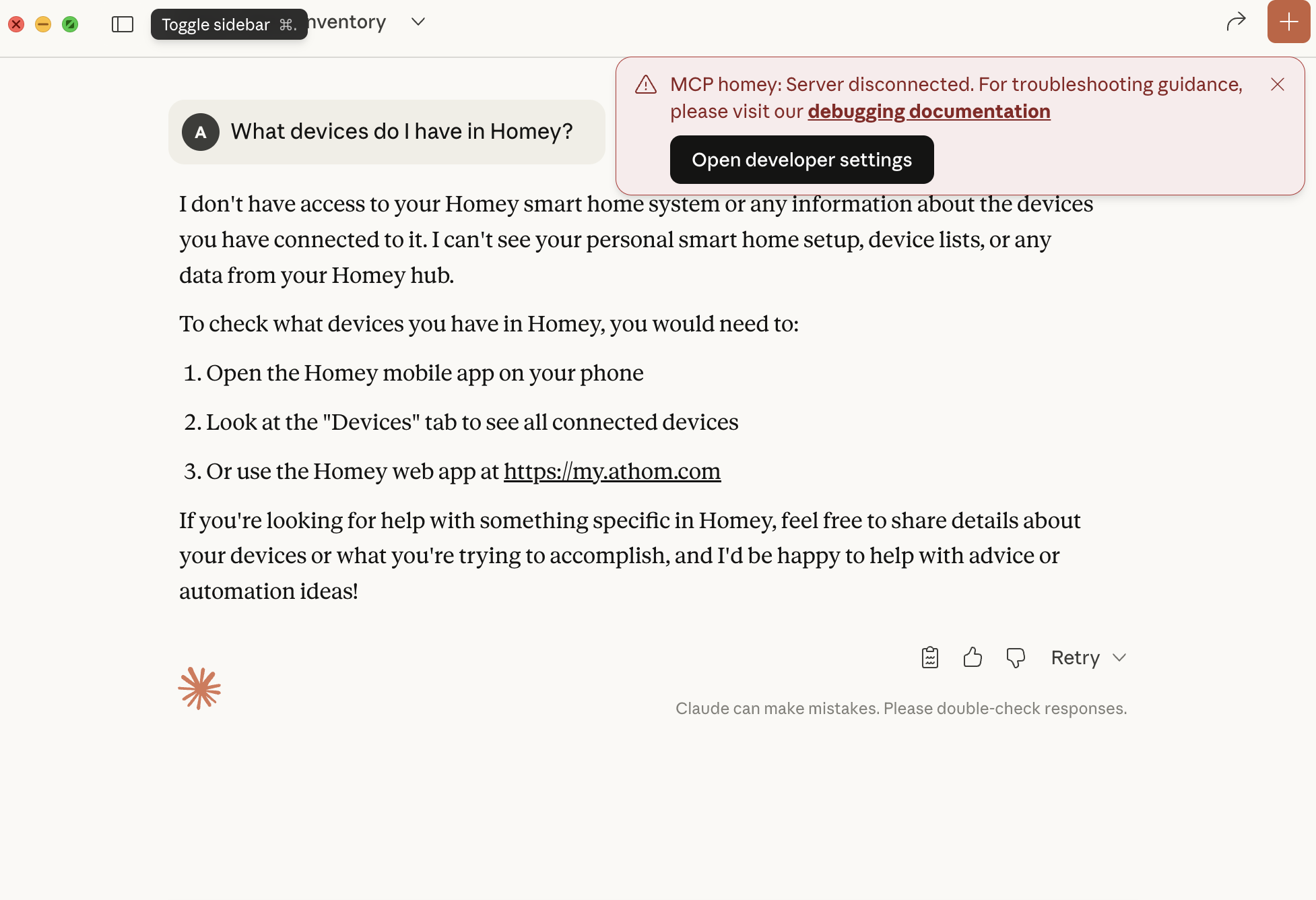

Hi everyone!
I really want to use this app.
I followed the setup instructions step by step, but it still doesn’t work.
Claude shows the error messages you can see in the screenshot.
When I open http://[YOUR-HOMEY-IP]:3000/health in my browser, I get the correct response:
{"status":"ok","message":"Homey MCP Server is running"}
Could someone please help me figure out what I’m doing wrong?
Thank you so much! :folded_hands:
Arnold
Hi @Arnold_Padutsch,
The error spawn npx ENOENT means Claude Code cannot find the npx command on your Windows system PATH. This happens because the Node.js installation path isn’t properly configured in your system environment variables.
Here are the solutions (try them in order):
Solution 1: Verify Node.js Installation
First, check if Node.js and npm are properly installed:
  1. Open a Command Prompt (cmd.exe) or PowerShell
  2. Run these commands:
node --version
npm --version
npx --version
If any of these fail, Node.js isn’t properly installed or isn’t in your PATH.
Solution 2: Add Node.js to System PATH (Windows)
If Node.js is installed but not in PATH:
  1. Find your Node.js installation path (usually C:\Program Files\nodejs\ or C:\Users\YourUsername\AppData\Roaming\npm)
  2. Open Windows Settings → Search for “Environment Variables”
  3. Click “Edit the system environment variables”
  4. Click “Environment Variables” button
  5. Under “System variables” (or “User variables”), find “Path” and click “Edit”
  6. Click “New” and add the Node.js path (e.g., C:\Program Files\nodejs\)
  7. Click OK on all dialogs
  8. Important: Restart Claude Code completely (Kill via task manager and reopen alternatively restart your pc)
Solution 3: Use Full Path in MCP Configuration
Alternatively, you can specify the full path to npx in your Claude Desktop configuration:
  "mcpServers": {
    "homey": {
      "command": "C:\\Program Files\\nodejs\\npx.cmd",
      "args": [
        "-y",
        "mcp-remote",
        "http://[YOUR-HOMEY-IP]:3000/mcp",
        "--allow-http"
Note: On Windows, you need to use npx.cmd (not just npx) and escape backslashes with \\.
Solution 4: Alternative Configuration (if npx still doesn’t work)
If none of the above works, you can install mcp-remote globally and use it directly:
npm install -g mcp-remote
Then update your Claude Desktop config:
  "mcpServers": {
    "homey": {
      "command": "C:\\Users\\YourUsername\\AppData\\Roaming\\npm\\mcp-remote.cmd",
      "args": [
        "--allow-http"
Replace YourUsername with your actual Windows username.
Verification Steps
After trying any of the solutions:
  1. Completely close Claude Code (not just the window - exit from system tray if needed)
  2. Restart Claude Code
  3. The MCP server should now connect successfully
  4. Test by asking: “What devices do I have in Homey?”
Since your health check (http://[YOUR-HOMEY-IP]:3000/health) is working, the Homey app itself is running correctly - this is purely a Claude Code configuration issue on Windows.
Let me know if any of these solutions work for you!

Hi @Jeroen_van_Menen,
Thank you so much for the fast reply!
I forgot to mention earlier that I am using an Apple M4 MacBook Air.
I followed your first step and installed the required tools on macOS — now Claude no longer shows the previous error. :white_check_mark:
However, now I’m receiving the error shown in the attached screenshot.
It seems like something is still wrong with my MCP configuration.
Could you please help me with what I need to set on macOS?
My current configuration looks like this (claude_desktop_config.json):
  "preferences": {
    "menuBarEnabled": false,
    "quickEntryShortcut": "off"
  "mcpServers": {
    "homey": {
      "command": "npx",
      "args": [
        "-y",
        "mcp-remote",
        "http://(MYHOMEYIP):3000/mcp",
        "--allow-http"
Thanks again for your help!
Arnold
Hi Arnold,
Just checkin: (MYHOMEYIP) is replaced by the actual ip Homey is running on in your real configuration? Let me know Jeroen
Hi Jeroen,
Well… I didn’t think I could be this amateur :sweat_smile:
The IP is correct!
Thank you again for the help, really appreciate it.
I managed to progress to the point shown in the screenshot below, but I’m stuck again.
I double-checked everything Claude suggested, but it still doesn’t work.
Do you have any idea what I might be missing? :thinking:
Thanks a lot for your patience!
Arnold
@Arnold_Padutsch are there any hints when you click on/expand the block with the text “Get home structure” ? Or ask Claude what the exact error is that it is receiving.
To diagnose the tool execution error, you can also check Claude Desktop’s detailed logs:
Finding the MCP Server Log:
  1. Navigate to your Claude config directory:
    • Open Finder and press Cmd+Shift+G
    • Paste: ~/Library/Application Support/Claude
    • Press Enter
  2. Open the logs folder in that directory
  3. Look for mcp-server-homey.log
  4. Open this file and scroll to the bottom to see the most recent error messages
  5. If the log file is very large: Delete it, then restart Claude Desktop - it will create a fresh log file with only new entries, making it easier to spot the error
Can you share what error messages you see in this log file? That will help me understand what’s going wrong when the tools try to execute.
You can also find this information in the troubleshooting section: AI Chat Control - Homey App Documentation
