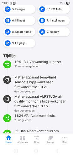

I have about 20-25 of the new matter enabled IKEA devices connected to my Self Hosted Homey without using the Dirigera Hub, is there a way to update the firmware of these devices or is the only way with the Dirigera hub?

You need to share your devices with a controller that supports Matter OTA updates, like Home Assistant or various Apple devices (ATV, HomePod).

Soon that’s possible with Homey. We have to wait untill they push that option. For now you could use the Dirigera hub to update your matter Ikea devices or Apple HomeKit or Home Assistant or other matter devices
Thnx @robertklep for pointing out the Dirigera hub is not the only device to update IKEA matter devices :wink:

That’s not correct, you can also perform updates from Home Assistant and Apple devices (and probably other Matter controllers too).
