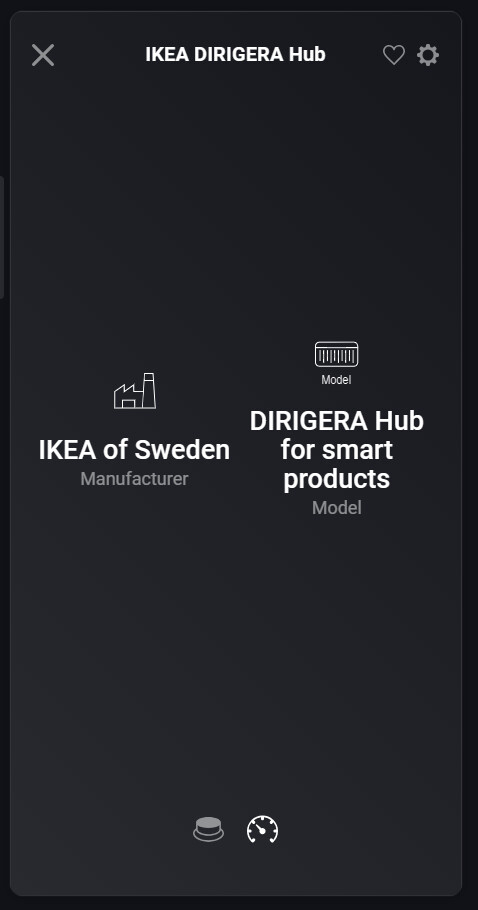

There might be a new way of using IKEA Dirigera from Homey, via HomeKit Controller App för Homey | Homey Homey can become an Apple Home.
I have joined my IKEA Dirigera that way, and it worked.
However, I joined my TRÅDFRI Driver för trådlös styrning, grå, 30 W - IKEA, but it isnt working as a light yet. The developer of HomeKit Controller is working on the issue.

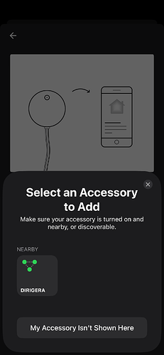

So, what i did:
  1. Installed the lastes testversion of HomeKit Controller App för Homey | Homey, currently 1.1.5.
  2. On my iPhone, in the IKEA Home Smart app starting the pairing process …
  3. On my iPad, checked on the logfile for HomeKit Controller that DIRIGERA is found.
  1. Went throug the standard process for adding a new device in Homey, selected HomeKit Controller and then my Dirigera.
Status right now is that I have my DIRIGERA, a TRADFRI transformer 30W and a TRADFRI control outlet added.
It works, but not perfect yet.
The developer of HomeKit Controller is working on the last details.
EDIT! A reboot of the Homey it self did the trick :grinning: :smiley:
