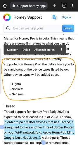

But yeah, then Athom should not have stated this black on white:
The beta allows you to pair and control the device types listed below.
- sensors
But we all know they’re always “a bit optimistic” in statements :sweat_smile: , and the word ‘beta’ is there with a purpose :innocent:

I had another go today and when adding the contact sensors I now got a notification that a thread border router is required. So only Matter devices without thread can be added I guess.
They wrote in the Matter anouncement you’ll need an external Thread Border Router for now

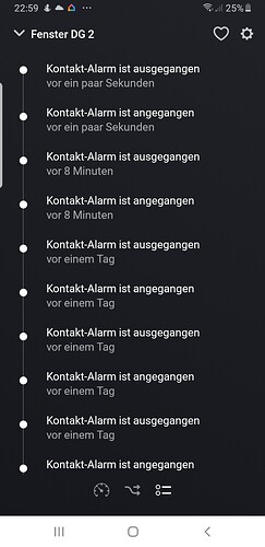

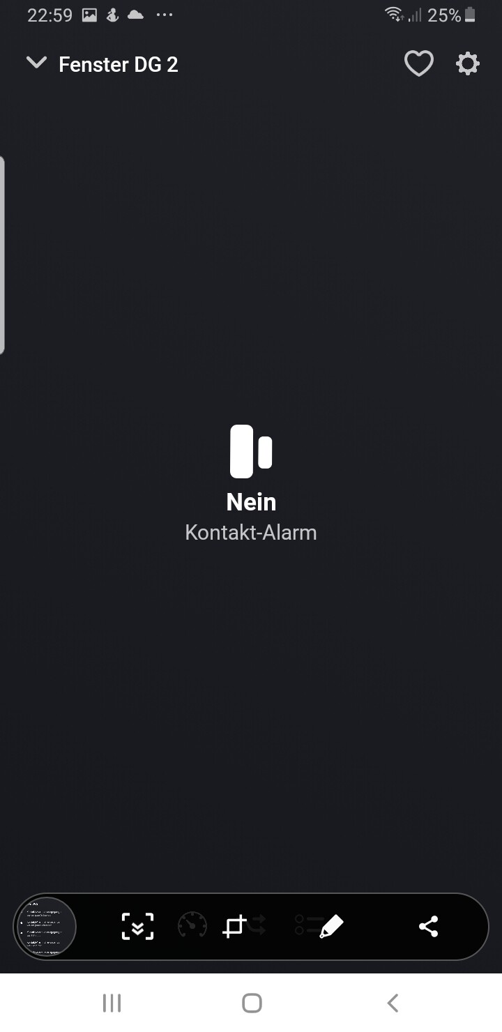

Hi, I could connect the aquara p2 sensors. 7 sensors yesterday. Everything worked perfect till today. Since 15 o’clock the homey doesn’t update the sensors state (open or closed) anymore. And I can’t add new devices…at the very last window where homey athom says connecting device to homey it stops. But interesting is,.that when you look in the timeline, there all device states are updating without problems!!! That’s curious. Ae also the pictures.
Does anyone know about that problem? Why did it work 2 days. Without problems, and stops now???
