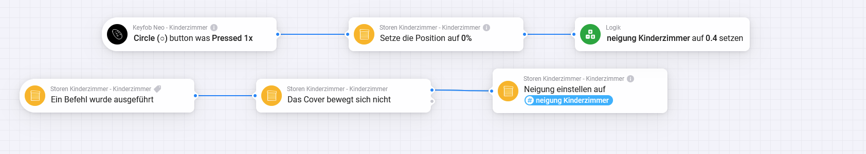

Lamellas - run down and then tilt
ok that works… :slight_smile: however next Problem
the position changed card trigers right away when the thing starts moving, not only in the end of the movement… so how do I do it after the movement is done @Adrian_Rockall ?

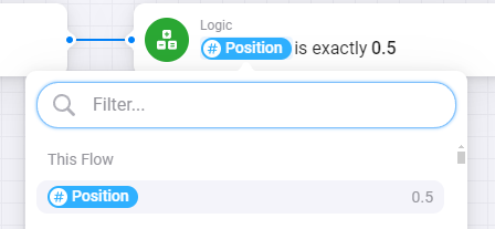

So, as @robertklep says, add an AND card that checks if the position has reach the target. That can be done with a Logic card and the #Position tag:
understood, however if I do this and start the flow with the one that sets to 0.4 tilt in the end it starts and instantly stops and tilts and stops still…? :confused: I don’t understand…
Did you send them to 100% before executing the second flow?
yes I tried that too, and also from middle or whatever.
strangely it also sometimes work as intended, but I cannot understand why sometimes it just stops and tilts…
tried also this version with no big difference:
There is an AND cart like “Lamelles do move”. So maybe you have to wait until they don’t move by using AND “Lamelles do move” is FALSE
so I did this, fromm 100 all the way down and it went all down but then didnt tilt…
when I did it from like 10% already it went down and tilted, I guess the time between the trigger of activating something and cover not moving anymore is too long?
(with the position changed trigger in the front from 100 it just runs 2cm and stops and tilts…) :confused: this makes so no sense :frowning:

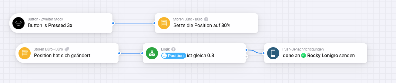

WHEN position has changed AND position is 0.5 THEN send a push message “position reached” to Rocky Lonigro.
As polling is involved, it might take a while before you get the message.

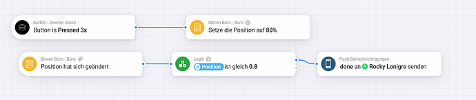

when i do this, the push comes right away when I manually start the top of these 2 flows:
i suppose setting Position is already then validating the logic… -.-
