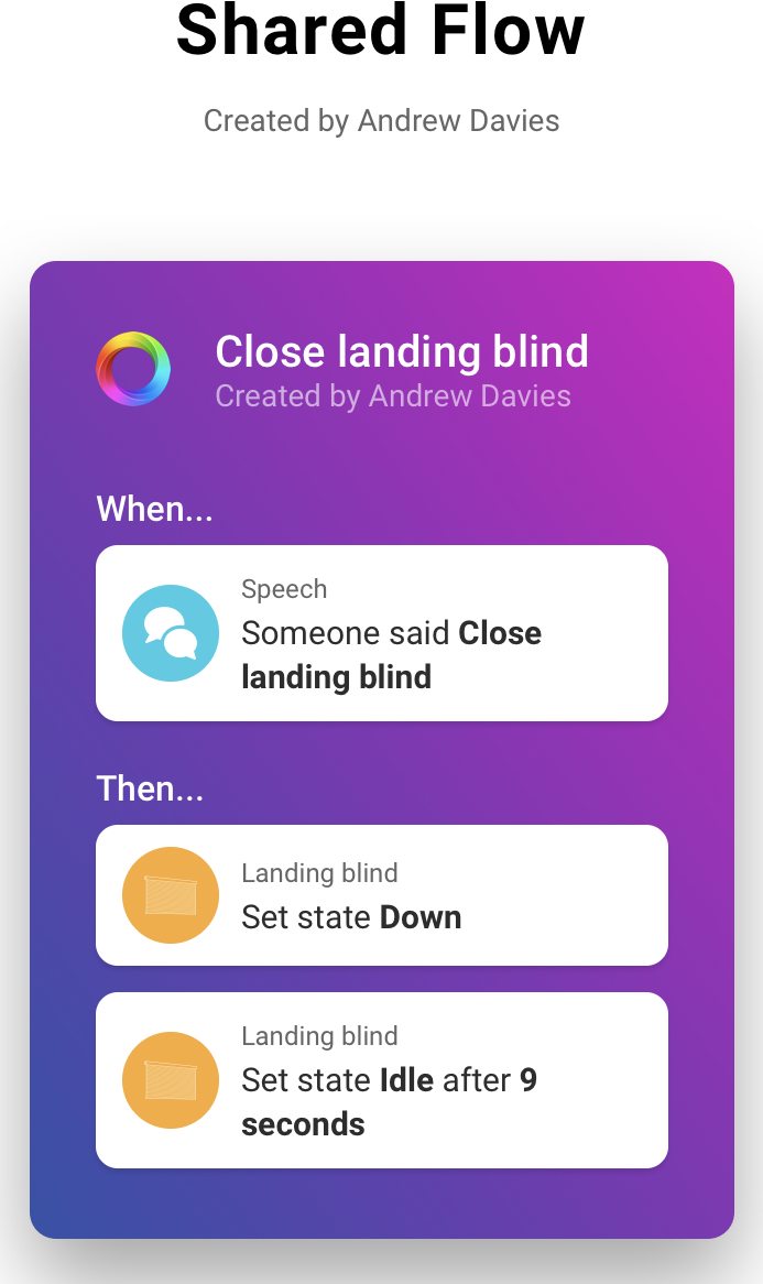

Many thanks for this - have managed to get it to work :+1::+1:
It was about me thinking in ‘blocks’ so rather than down for 9 seconds need to stop after 9 seconds…
Lots more to learn - thank you for the help - will be looking to sort some sensors next… :smiley:
