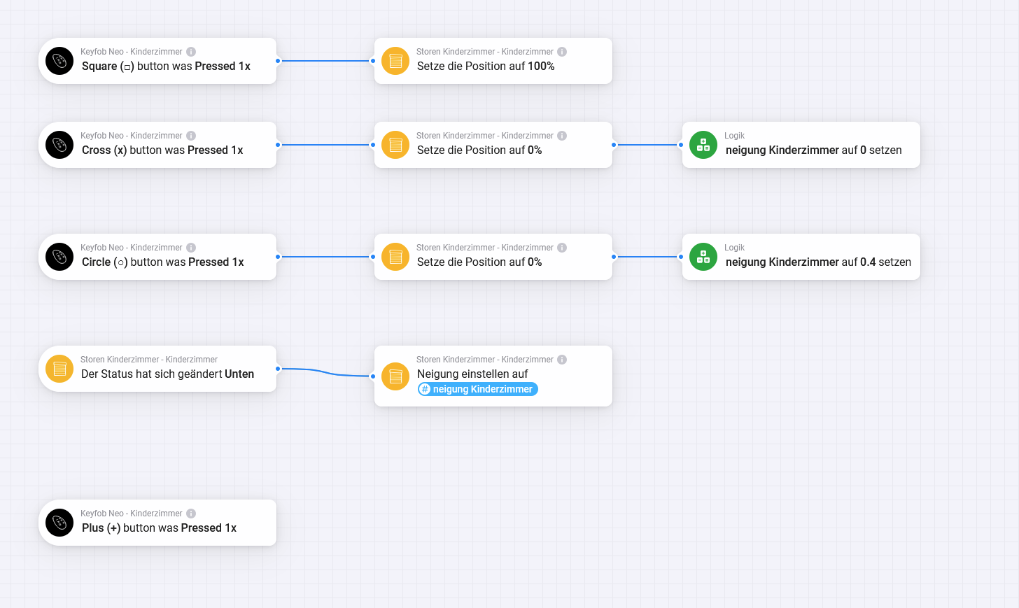

Lamellas - run down and then tilt
The second flow will run several times as the position is changing all the time till 80%. Appearantly the first time this flow runs, the AND is already true. Then position is not the actual position but the position the lamellas are sent to. @Adrian_Rockall will find out.
There is also a card “WHEN state has changed”, which might do the job but which states are available? Stopped, started, moving, ……?
Is there a state which indicated the lamellas are at the requested position?
no there is just up down and inactive

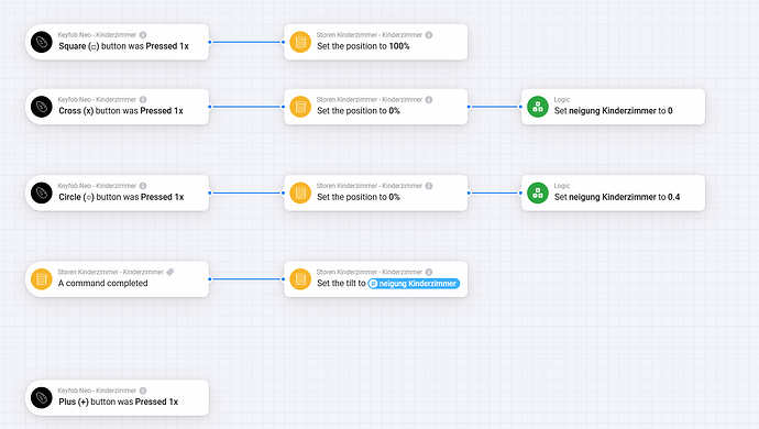

so for the below flow i did click square first it started all the way down. went all up
then i clicked circle - it went down 5 cm and stopped.
then i clicked circle again and it went down all the way
and yes I have the buttons, but I cannot find a command for a flow to “use” the stop button?
The card to use the stop button is the set state:

I already have that card in there right? so now you mean to add using some of those state green tag:
? or what do you mean exactly? also its saying down, when they are full open atm…

That does not look like status of “WHEN command completed”.
Connect the card “WHEN command completed” with the logic card first, only thén you will see the tags from the WHEN card (of course :wink:).
thats the only thing i see…?
Command name is text, so the logic card you have chosen can see it.
The other tag is a boolean, so requires a logic card that supports true / false.
You won’t see a value there because it is only available when the Flow is triggered.
so what am I supposed to try now?
did the other log i sent you help in any way?
So add the Command completed trigger and check the command tag is equal to the required value, e.g. “Move Position 100”. I can’t be sure that’s the exact text as I don’t have the same device as you, so maybe log the tag to the time line to see what it is.
Once the correct command is identified, then tilt the screen.
you mean this one: successfull = true?
No, the Command Name. You will need to make sure it is the move up / down command that completed and not the tilt.
and I can somehow see that command name when running tests?
For testing, link to the Then card ‘Timeline’ ‘Create a notification with’ and put the Command Name local tag in the box.
Then when the card triggers it will write the text to the time line.
