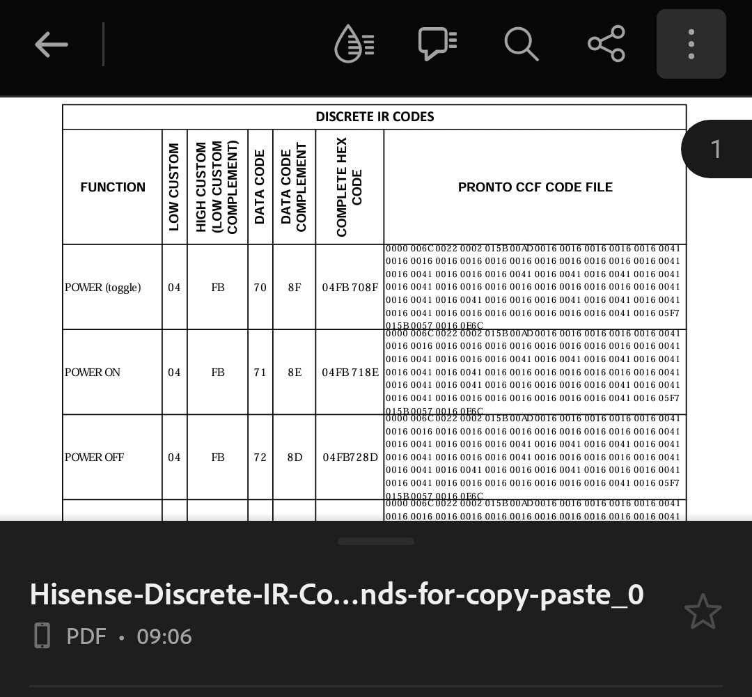

Btw just to be sure,
You also checked the codes hisense published?
But i guess thes didn’t work?

THAT WORKED!
I am embarrassed I did not find this myself - I swear I did a LOT of searching for Hisense L9G IR codes on the Hisense website, various forums, IR websites and general googling, but I think my mistake was always including the model name in my search. These appear to be older generic Hisense codes that didn’t come up in any of my searches, but at least the discrete ON and OFF commands work perfectly. Thank you @Dijker for your superior googling skills, and for sharing that document!
This basically solves my problem to 100% satisfaction, but now I’m invested in figuring out what’s going on with the built-in Homey IR functions. I’m still getting that IR receiver and will report back with more diagnostics, in case that helps fix similar problems for other devices.
