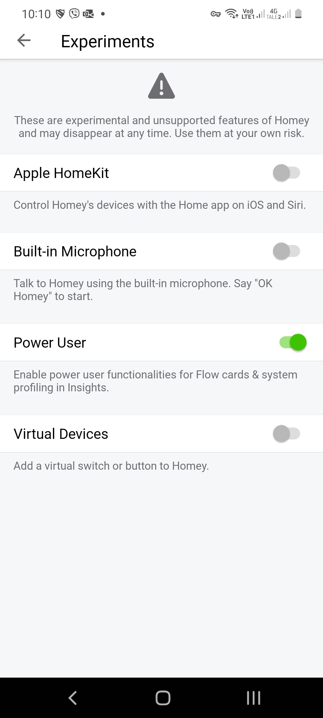

[Here would be a prnt-scr of the Experiments menu, showing a microphone option. Can’t put more than one pic in the first post ever]
A mic? This is an older version isn’t it? FuuuuuaaaAAAA!!

I do not think (and hope) you got an old one. I do have the mic option but it does not do anything.

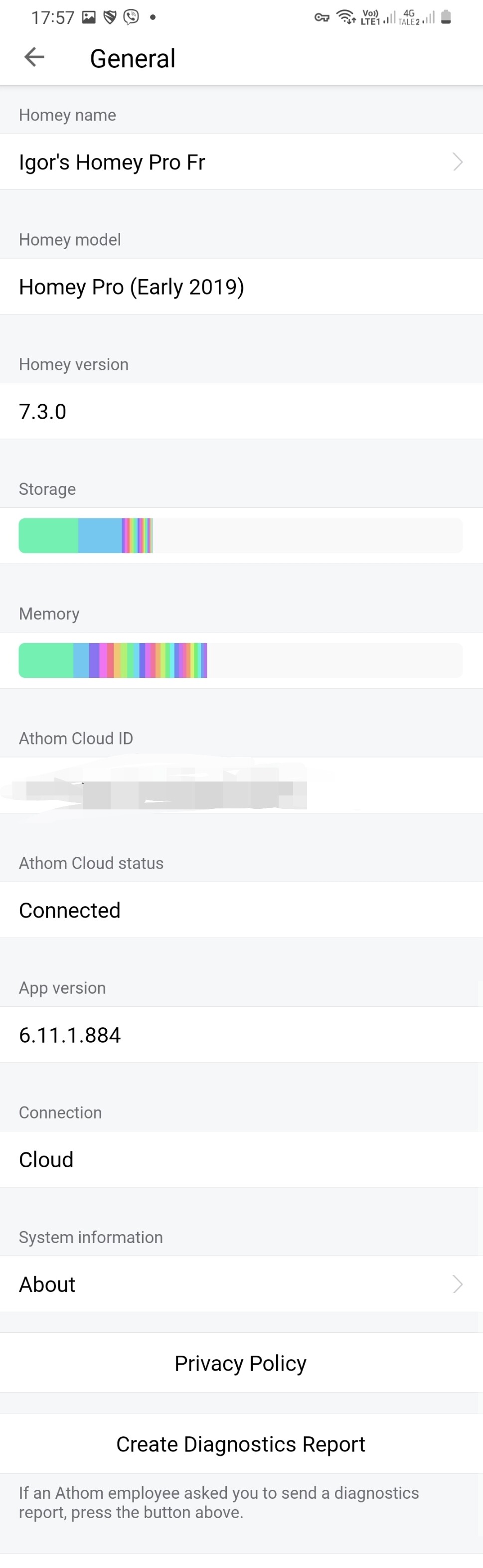

What type does the more - settings - general screen show?

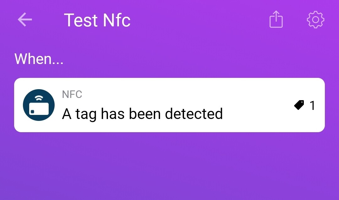

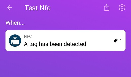

The reason I think it has NFC is that it is an option as a trigger in flows. I can’t remember I had that before… I am 90% sure that I didn’t have the microphone option in experiments before.
I had the Pro version before, and the box says I received the Pro now as well, as does the settings screen.

My best guess is a configuration bit flipped, making Homey Firmware (there is only one) think it has a NFC and Mic installed.
but without the NFC Chip and antenna and a Microphone installed I expect it isn’t going to function.
Officially there have never been Homey Earley 2019 or Homey Pro’s with an NFC / Mic.

Despite the microphone that is still under experiments,
it is discontinued since some time
o, and btw that was for a reason it is discontinued…

Tried NFC as well. Sounds good, doesn’t work.
