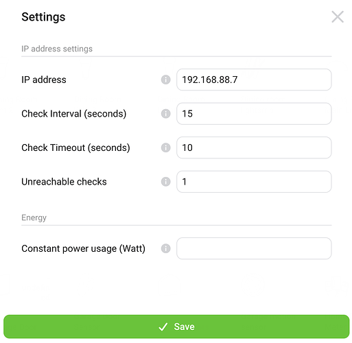

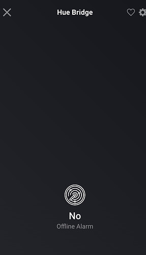

And/or consider using Net Scan App for Homey | Homey
to monitor the Hue IP address, to check if Homey can reach the Hue IP
Interesting app. Didn’t know it existed… I configured the IP and it seems that Homey can see it…
