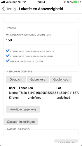

I wanted to add a second user (my GF) . so I added user Kirsten in the Homey-L&P-app and got a tokenID. next I installed Owntracks on her I-phone 6S
I set-up the HTTP broker
https://.connect.athom.com/api/app/nl.scanno.owntracks/events/?token=
Uder Kirsten (same as in L&P-app)
cloudid
 same as mine
tokenid
 her token
As soon as I’ve done all this I imediately get a notification on my own phone from the Homey-L&P app
saying “Location & Presence: Device Changed for user.Kirsten to httpendpoint”
So I guess she’s recognized
 and when I add a Geofence in her Owntracks-app I (on my phone) get a notification that Geofence X is added and it is also visible in the L&P-app settings .
but somehow it does not work
 the app won’t pick up her location
 her location stays “Undefined”
:cry::cry::cry:

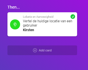

When I test her presence in a flow
I tried several ‘moving’ modes in Owntracks
made her “beheerder” in Homey
Deleted everything and started all over again
nothing seems to help
What am I doing wrong??

  1. Geofences are personal? cannot share them?
  2. I cannot add a fence in the L&P app
 well I CAN add a fence but is has no coördinates
problem is that on adding a fence, Only the “Fence” field is accesible and when I push the + button the fence is added but without Lon/Lat/Radius
In the near future I will set myself on learning how to set up and use a MQTT broker çus the https broker works really fine, but Damn! is a battery-drainer
 :slight_smile:
To answer your question:
  1. Geofences are not personal and can be shared. However at the current version for HTTPS users it is not yet possible to share those geofences. When using MQTT you can push the geofences to the owntracks app on you phone. I am working on a complete overhaul of the homey app that supports pushing data to HTTPS users (you can also see the location of other users in the owntracks app on your phone). But due to the master i am following (next to 40 hour workweek) that is on hold.
  2. Geofences are added autmatically when they are created on the phone. So please use that.
The best thing you can do is create a geofence on the phone with the same name and copy the coordinates from the other phone or from the homey app.

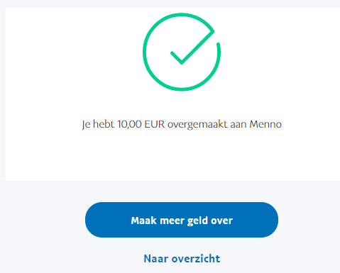

Nice thx for support, you deserve a Nobel price for support
not make you rich, but to show my appreciation
