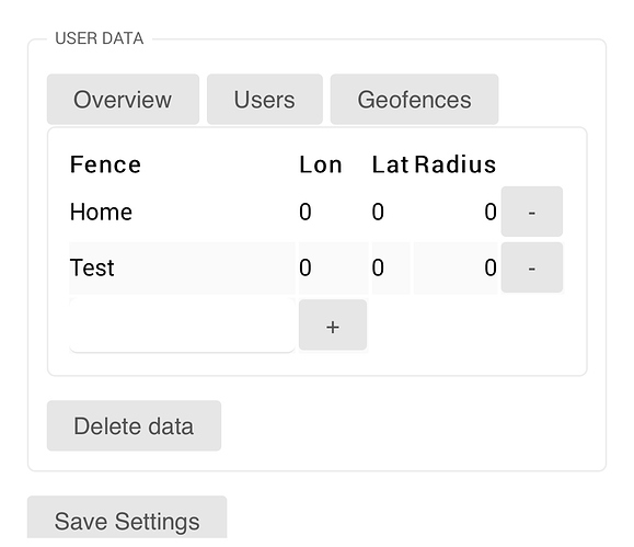

It seems to me like Owntracks works in Location and Presence, but the Geofences is not working?
How did you create your geofences?
You should create them in the own tracks app on your phone. The fences should be created automatically then in the location & presence app on Homey (including lon/lat/radius)
As I told you on FB, you have to set a radius to your geofence!!
Hi PO. Nice to see you here too. :slight_smile: I have the default radius of 150 meters set in Location and Presence. In Owntracks it’s set to 150 there too.
