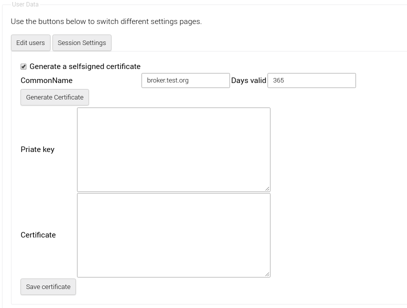

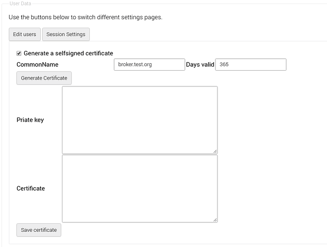

Generating a selfsigned certificate is very easy with the MQTT Broker for Homey. After you have installed the MQTT Broker for Homey from the App Store, go to the settings page an go to the Session Settings. On that page check the Generate a selfsigned certificate checkbox.
In the CommonName field enter the DNS name where your Homey resolves to (or use the internet IP adress). As default the Days Valid field is set to 365 days. That means that the certificate will be valid for 365 days. After 365 days you will need to generate a new one.
After entering the CommonName field, just press the Generate Certificate button to start generating the selfsigned certificates. Please be patient because it can take up to 30 seconds (or more) until the generation has been completed.
Once generation has been completed, you will see the Private key and Certificate text boxes filled with data:
After the text boxes are filled, the generation process has finished. Press the Save certificate button to save them the the internal storage of homey.

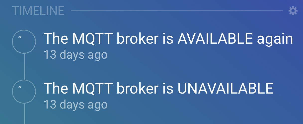

Hi there, since a few days, my MQTT Broker is somehow rebooting many mornings between 7:20 and 7:24am, and sometimes in the afternoon.
I’ve got those messages in Homey:
The MQTT broker is UNAVAILABLE
The MQTT broker is AVAILABLE again
I’ve got no flow that intercats with the app. The big change i’ve made lately is Node-Red MQTT connected in a Raspberry. Any thoughts?
U get the same when WiFi is down:
So it may be my Orbi that’s reseting the connection with Homey? I’ll take a look into that, thanks.

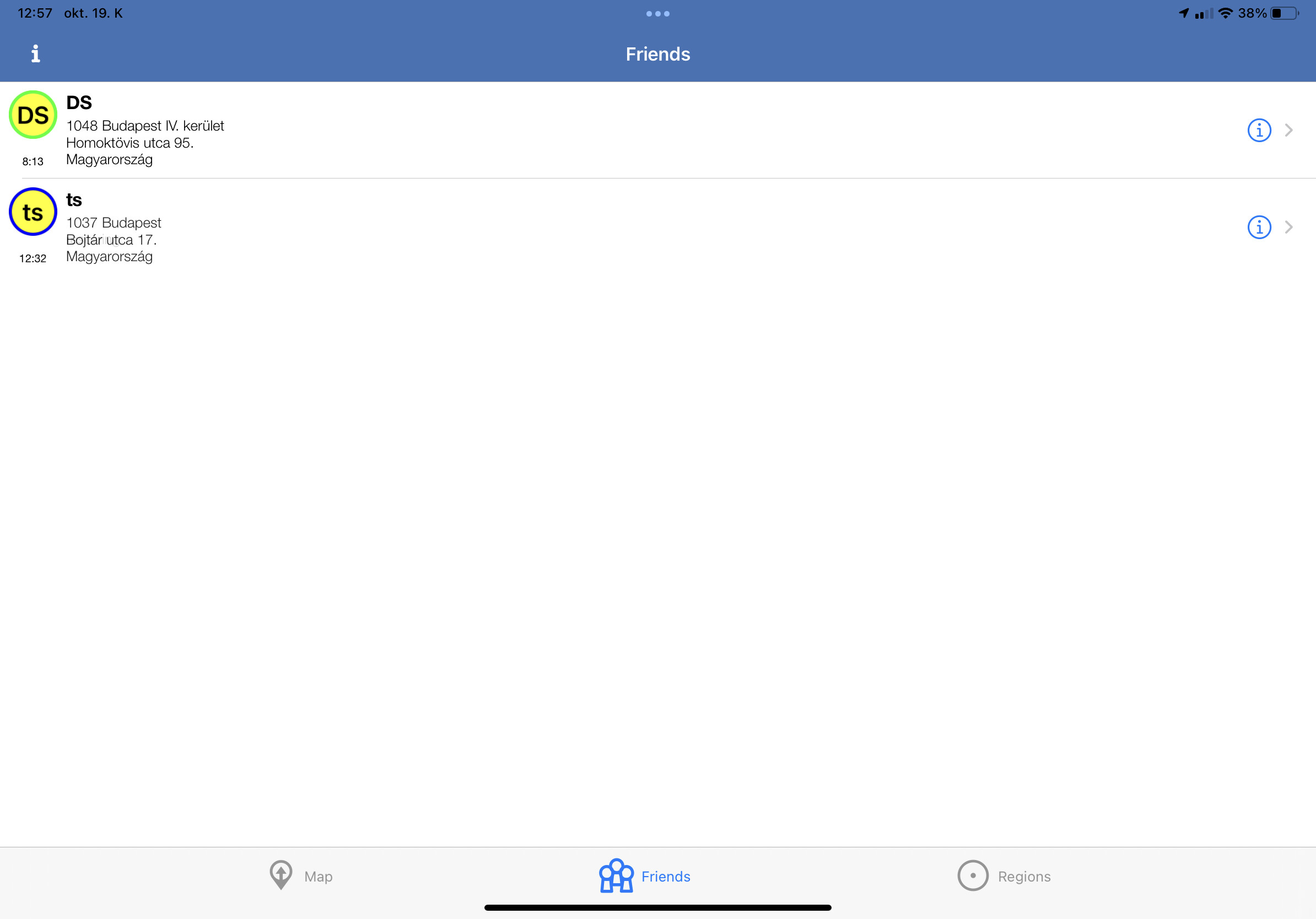

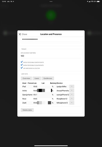

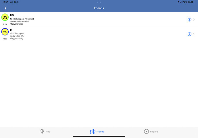

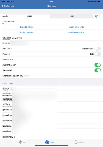

I set my homey mqtt broker there are all family member owntrecks but I not see all member, only one. can you tell why? Or I need install mqtt my synology and that is work fine… I need help. thanks .
I installed the homey mqtt broker and location & persence and iPhone owntracks. I only 1 account add to mqtt broker that is I used location app configuration
And the owntracks settings dns and separate userid like wife name and childrens name but same password make broker settings. There is connection is connected. And see all devices location & presence app configuration page.
