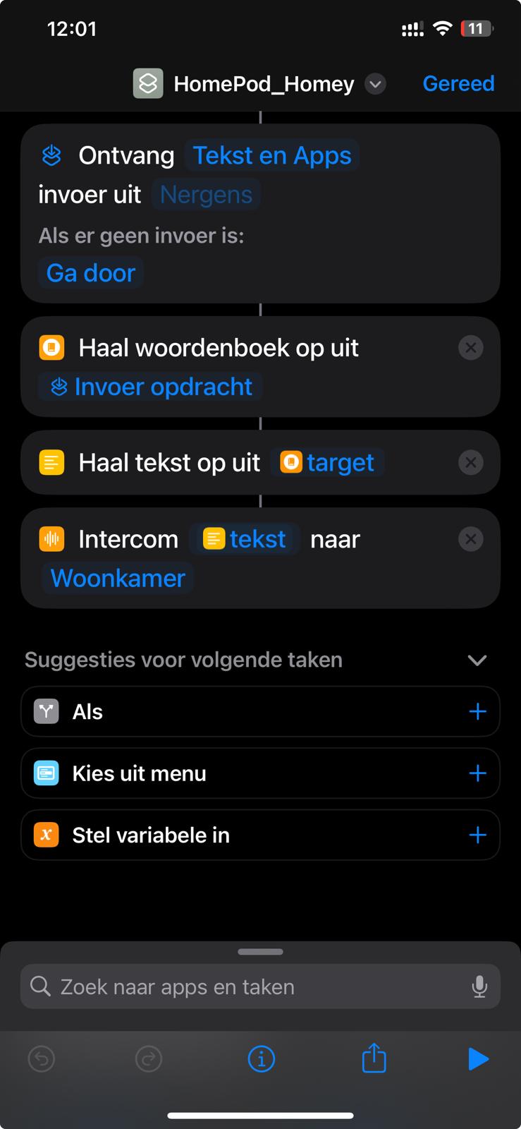

What do i wrong?
Edit: I know whats the problem i dont have a puschcut server but how do i set that up? I have a running server but how do i get a link for homey

It works but now the homepod said Woonkamer and not the message?
Assuming you’re correctly setting the HomePod_Speech variable in Homey, then check the Intercom action in your shortcut - should be picking up the “message” item from the dictionary it gets as input, not the target item.
