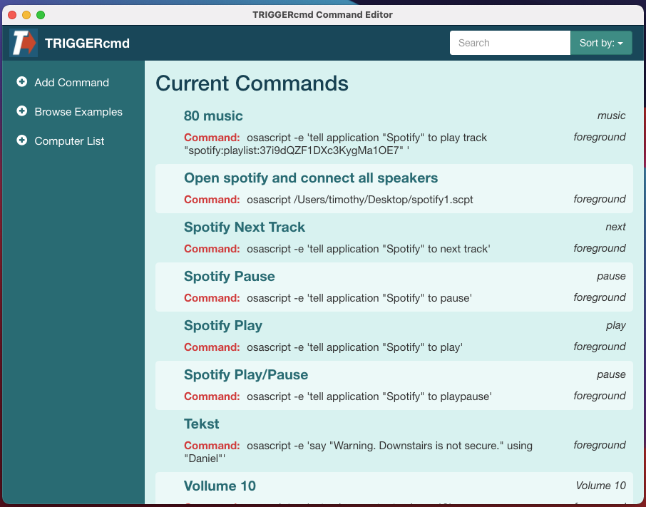

So i can trigger a playlist from spotify with TriggerCMD as follows:
osascript -e 'tell application "Spotify" to play track "spotify:playlist:37i9dQZF1DXc3KygMa1OE7" '
There is a lot of code pre programmed. The buttons from spotify are all in TriggerCMD already and thats fairly easy. I am missing the shuffle command. And try to fix that in the up coming weeks.
I need to do some testing on muting / unmuting single speakers when a motion sensor is triggered.
