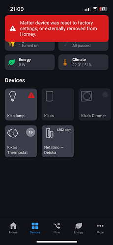

As actually - I reset my Dirigera - added there one bulb - and I tried to share it to Homey Pro 2023 via Matter bridge.
Adding process seems OK – But always directly after device (bulb) is added to Homey, it shows error – see added pictures.
Am I doing something wrong ? I tried to restart both devices (dirigera and homey pro) but same result.
