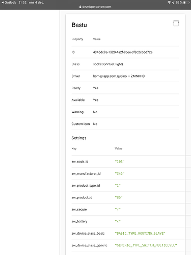

Qubino Minidimmer shows up as switch in Apple Home app . is it possible to fix so it works as dimmer ?
Can you find the device on this page and post its capabilities here?
The fact that is shows up as a socket instead of a light is unexpected, because Homeykit checks virtualClass first and should see that the device has light as virtual class. But because it’s apparently seen as a socket, it should explain why it can’t be dimmed from Homekit, because the default Home app on iOS doesn’t support dimming on sockets (some other apps, like Eve, do support it, I think).
Not sure how to fix this.
Ive got it to work . Removed and Add in homeykit app. Now it work and is dimmable in Apple Home App. :wink:
When you add a Qubino Minidimmer its default virtual class is “other” so after its added change to “light”remove and add it in homeykit after that it’s correct identified as dimmer in Apple Home kit
