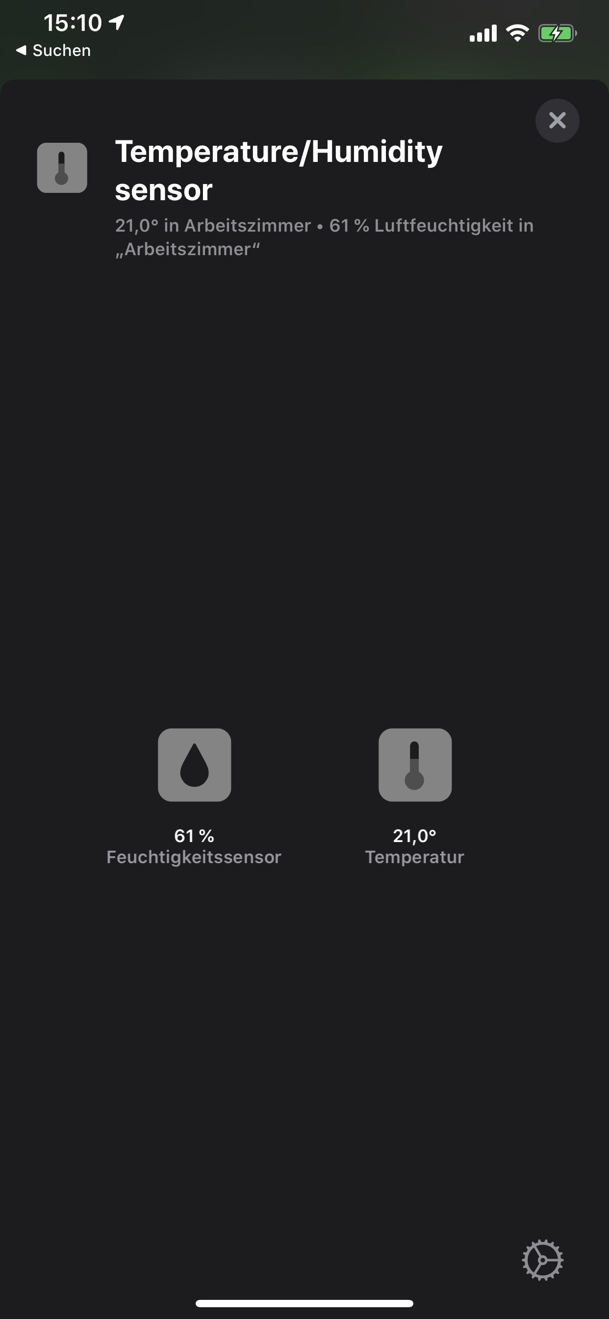

However - The sensor is recognised as 2 sensors, shown as one. When entering the details it shows 2, clicking on it reveals them finally (see pics).
I tried to ask Siri and it works for the temperature though not for humidity.
