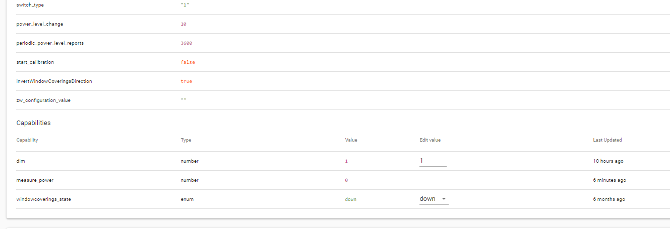

Below the information in screenshot…
The issue is that Homeykit uses “50%” when the state is set to “idle” (which is the case in your situation).
It looks like @Phuturist assumes that windowcoverings_state reflects the state of the device while active (so it’s either “going up”, “going down” or “stopped”), whereas Homeykit assumes that it reflects the state of the device in rest (either “open/up” or “closed/down”).
I don’t know who’s right here, these things are not well documented, but it makes sense that it reflects the active state. It looks I can shuffle things around in Homeykit a bit so it will start using windowcoverings_set instead of windowcoverings_state to reflect the position.
Here’s a test version to try out (v3.0.16): HomeyKit | Homey

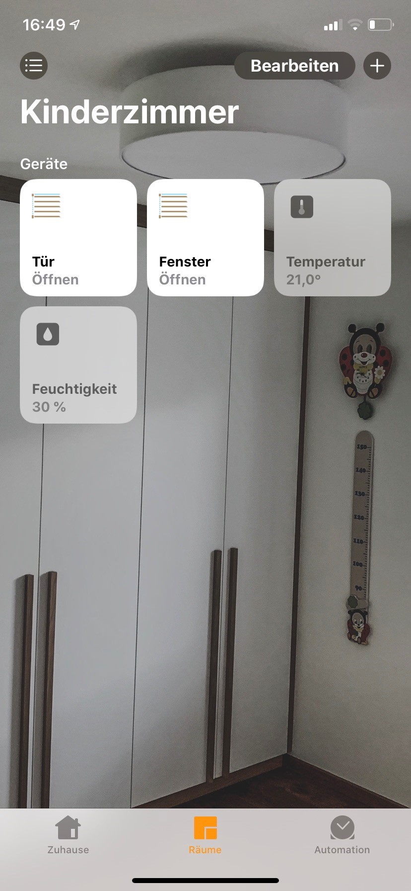

Hello @robertklep,
could you plese help me also for my problem?
Also if my blinds are closed the home app shows them as “opening” and not “open”.
Thanks
Philipp
I don’t think I understand your problem entirely. Do you mean that it’s always showing “opening”, no matter if you’re opening or closing it?
hello robert,
no no only when the rollo shutter is opening but also when it‘s open, wenn it‘s closed then it‘s shown as closed.
thanks
So instead of “open” it’s showing “opening”? But when it’s closed it’s showing “closed” and not “closing”?
correct
What type of device is it specifically? Brand and model.
The text shown for the button in the Home app is not under control of Homeykit, so I don’t think there’s a lot I can do about it, but perhaps the implementation of the driver may provide some clues.
hello robert,
i use the fibaro roller shutter 2.
best regards
philipp
Sadly, the Fibaro app code isn’t available so I cannot see if perhaps the device doesn’t “dim” from 0—1 but from 0—0.99 or 0.01—1.0 or something, which could explain why it’s being shown as “opening” instead of “open”.
So there’s not much I can do here. It’s not something obvious in the Homeykit app that I can change, it has to do with the specific device’s capabilities.
Ok thanks a lot.
