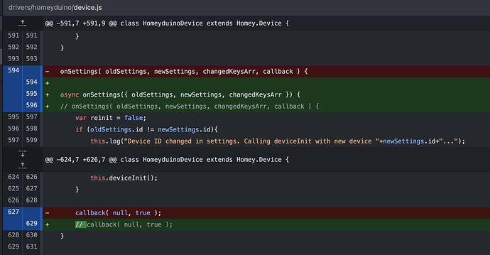

final fix is we need a buffer or queue until we have a good json.
Let’s hope Athom reads this thread… likely not… raise a PR on their Homeyduino Github.
probably never, I think there is now a new policy that you can have the same app twice, with a different name off course.
thanks for converting the app to sdk v3, this is my last change about the app in this channel.
but if you want to change your device settings like enable polling or change ip without doing your flows again, you have to do this on your device.
