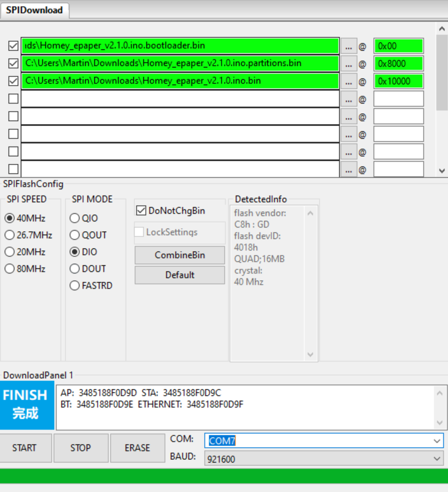

With Flash download tool I get this error (in serial terminal):
ESP-ROM:esp32s3-20210327
Build:Mar 27 2021
rst:0x7 (TG0WDT_SYS_RST),boot:0xc (SPI_FAST_FLASH_BOOT)
Saved PC:0x40043ac8
Invalid chip id. Expected 9 read 0. Bootloader for wrong chip?
ets_main.c 329
And config (for S3 bootloader addres need to be on 0x00)

Thanks, this is what I get now from COM terminal:
Build:Mar 27 2021
rst:0x8 (TG1WDT_SYS_RST),boot:0xc (SPI_FAST_FLASH_BOOT)
Saved PC:0x40378785
SPIWP:0xee
mode:DIO, clock div:1
load:0x3fce3808,len:0x44c
load:0x403c9700,len:0xbd8
load:0x403cc700,len:0x2a80
entry 0x403c98d0
But no output on the screen.
Thanks
Bootloader address need to be at 0x0 see here.
Partition address here.
Otherwise you can try Async elegant OTA method, you only need to change “esp32 dev module” to “esp32s3 dev module” in the selected board.
Before upload it, can you go in (in arduino IDE) Preferences and check the upload box “Show verbose output during”. Because if it works, you will find the addresses in the output monitor and i can add it to the guide.

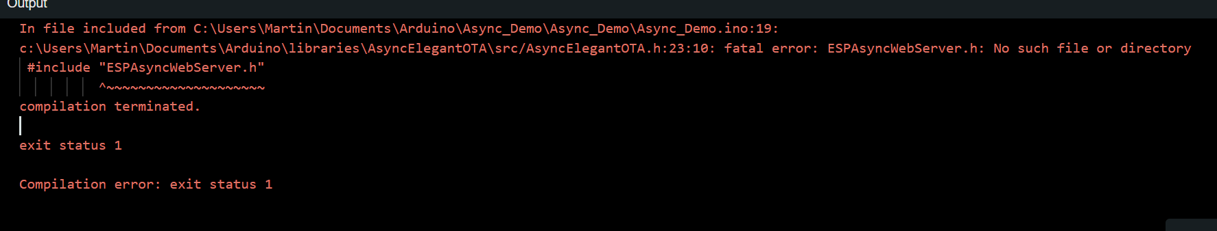

Install EspAsyncWebserver in library manager.
I will try new OTA v3…
EspAsyncWebserver is replaced by EspAsyncWebSrv.

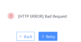

Many thanks for making it available. Solution 1 and 2 weren’t working for me. The ElegantOTA immidately goes into error when selecting the bin file:
Uploading the v.2.1.1 in the ArduinoIDE was working.

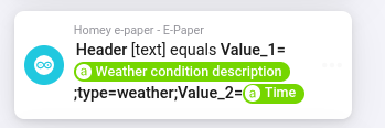

Is the Weather in the Header area also supposed to have an icon? I cant get that one working.
Also the battery percentage is staying on 0% and not changing. Any way to get that working? Already did the Battery Calibration.
Wich board do you have?
The header is free to display.
If you want weather icon change dynamically, see “Type” in guide.
Actually works with OpenWeatherMap.
Hej, This is the LilyGO TTGO T5 4.7 inch E-paper E-ink ESP32 V3, was working fine on the 1.3 version.
Open Weather app is installed, currently I have this as header:
You need to use it like a device:
There is no icon in the header.
