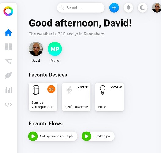

@David_Petterson are you sure they’re in your fav device list?
As a comparison: do they show up at my.homey.app favorites?
Both homeydash & my.homey.app should display the same favorite devices.
Hi. Thank you for your reply.
I am afraid so. :pensive:
lør. 20. nov. 2021, 15:52 skrev Homey Pro (512MB) via Homey Community Forum <athom@discoursemail.com>:
Thats odd… No clue why it differs, sorry.
