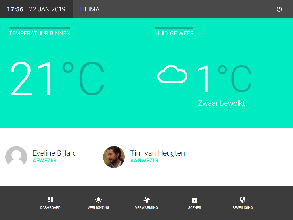

I’m creating this in React and using Athom’s Web API. It’s a bit of a struggle, but here are two screenshots of where I’m at right now:
Dashboard
  • The dashboard shows the indoor temperature and the outdoor weather (fetched from Dark Sky using Homey’s lat/long). It also shows all users and their presence status.

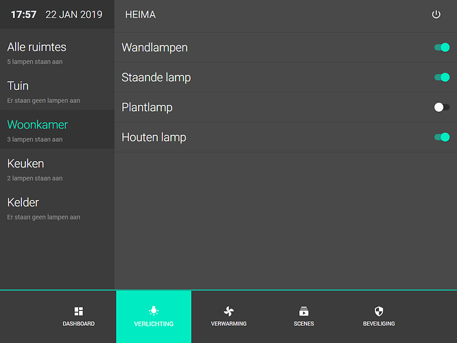

Lighting
  • The lighting page shows Homey’s zones on the left. The upper zone is the root zone (in my case I named it ‘All zones’ in my Homey app). On the right you see all devices fetched from the Web API filtered by the device class or virtual class. As you will see in the video my Homey has more zones then listed, but zones without a light device are not rendered.
  • Lights can toggled on/off. Toggles from the Homey app, a wall switch or keyfob are reflected in the dashboard by listening to the device capability updates.

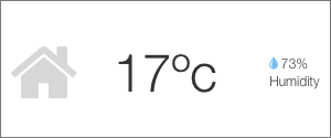

Weather Showing the current temp is great, but generally speaking I would like to know whats the temp, whats the high/low and ‘general weather’ (cloudy), finally I find it useful to show what the ‘trend is’ -> is it 21 and getting warmer or cooling down. Obviously it could be hard to show this information in a way which isn’t over complicated and everyone can understand … I feel that the UX below is nice and easy to understand while giving maximum information.

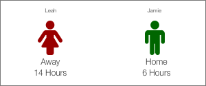

Presence : Presence is an interesting one, if I am home, then I know who else is home … So as well as knowing who is home, sometimes is just as important to know when your kids got home. … or left. I also prefer the use of visual clues so the information is available at a glance. (fade effect in the avatar of people not home).
