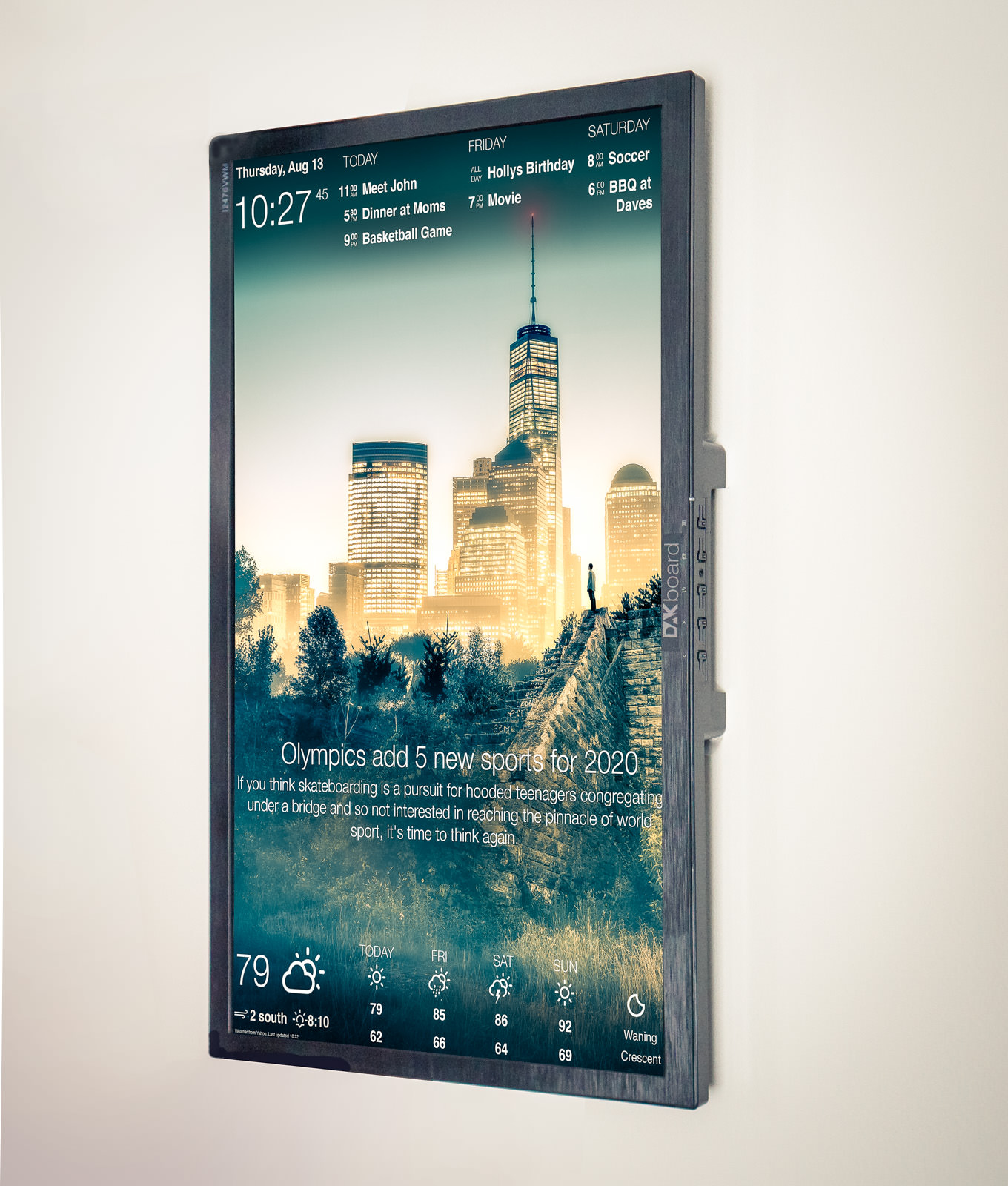

I’m using DAKboard for this: https://dakboard.com/site
It looks very good. Can you integrate dakboard with Homey?
Yes, same question! ā€œI’m using DAKboard for thisā€ is not a very usefull answer :joy:
You can integrate Homey dashboard in DAKboard using the website/iframe integration. But it will cost you money, because you need a paid version of DAKboard.
Alternatives are maybe http://dashing.io/ and https://github.com/Freeboard/freeboard as dashboards to integrate homey dashboard within.
