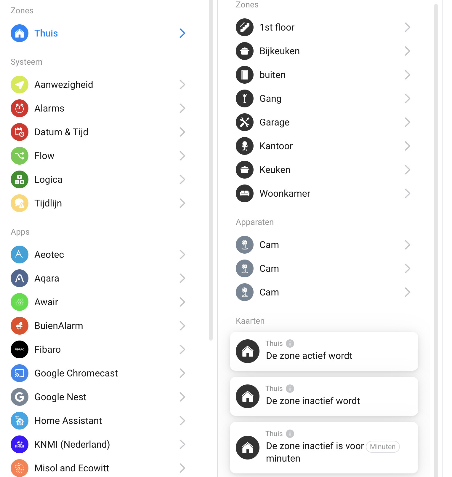

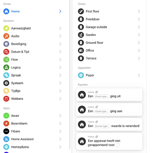

Hey,
is the alarm type went on or off flow trigger gone on home zone level? on the old homey pro I can use this in the flows , now I need to add all the door sensors.
