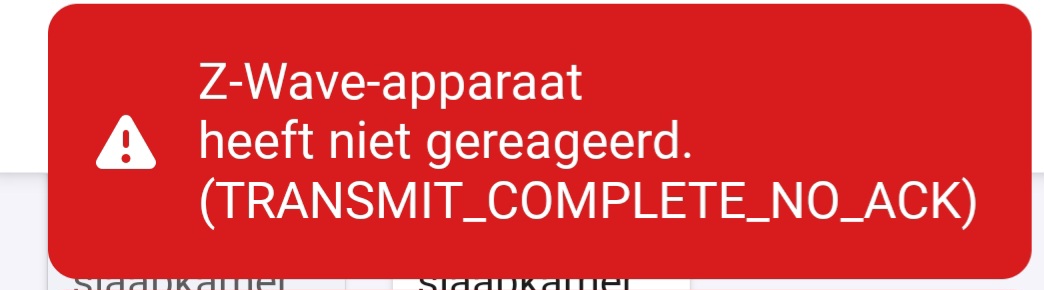

I still get the following message with many of my Z-wave modules: Transmit-complete-no-ack.
TRANSMIT_COMPLETE_NO_ACK is not the same as TRANSMIT_COMPLETE_FAIL, a no ack error can be caused by several other things, like the distance, so Homey Pro can’t reach the device which is more likely.

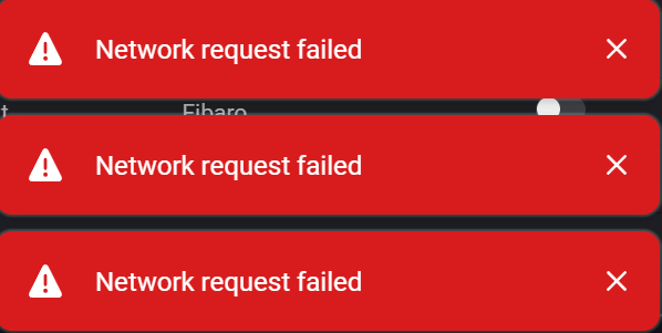

v10.1.0-rc.4 is not a solution for me TRANSMIT_COMPLETE_FAIL has simply been replaced by “Network request failed”
network request failed is the developer tools/Web GUI failing to connect to your Homey, has nothing to do with Z-Wave
Interesting. That’s actually the error that comes up on the web UI: https://my.homey.app/homeys/
(not Developer Tools https://tools.developer.homey.app/tools/zwave)

Previously I never got the “TRANSMIT_COMPLETE_NO_ACK” but now I get it with all my 800-series devices (shelly 1pm wave) and I can not control them. I also have problems with some 700-series devices.
