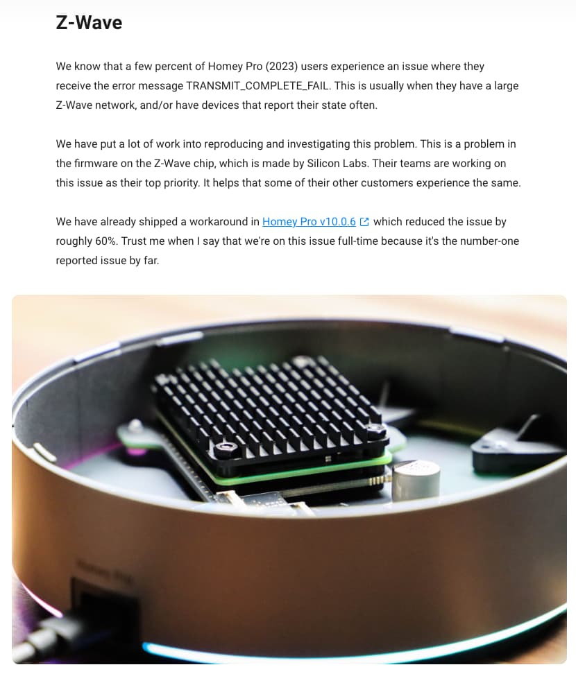

Emile wrote ” We know that a few percent of Homey Pro (2023) users experience an issue where they receive the error message TRANSMIT_COMPLETE_FAIL.”. However I don’t trust him because from what have seen in different groups on internet this seems to be much bigger than a few percent.
So please, I would like a much more detailed time plan when this can be this fixed!

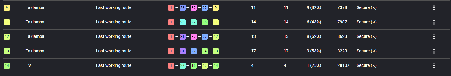

I should also add the my system cover a large area with 4 diffrent buildings. I have ONLY z-wave plus units and many of my units uses max number of hops, as can be seen in the picture.

This last week they completely admitted to a major issue concerning z-wave that they are pinning on their vendor Silicon Labs seen here An update on Homey Pro's roadmap — Behind the Magic | Homey
It looks like we might have to endure this rough patch for the time being. It seems they have delayed Thread because of a similar thing or maybe resource constraints trying to get z-wave stable. but either way I think it will be a few months before we see any relief to this issue.
