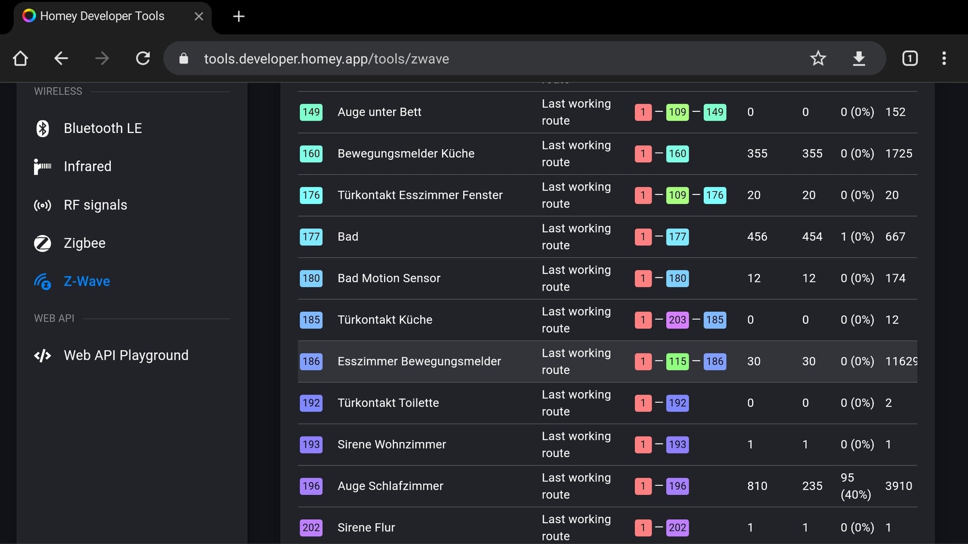

“…do this for all devices with a high Rx value.”: What is a “high Rx” value, exactly?
There is not even any definition of what the columns mean in the developer page (leaving aside that no consumer user should even have to know about this to make their device function).
I note from your earlier comments, you “…believe the TX and RX are since the latest restart”, and your observation that “Most of the time the issue starts when RX numbers go up with 30-40 per second”, but surely Athom make clear what trigger these messages and what they are supposed to mean to developers (i.e. users of the developer pages)?

Can you please share your screenshot of the setup so I can compare?

I have, 11 Aeotec multisensors - mains powered, 5 Aeotec recessed door sensors, ~40 Fibaro relays/switches, 5 HeatIt thermostats, 6 Fakro window/blind (mains), ~35 Sensative Strips (none of which are working with HP23). All the Fakro, HeatIt and some Fibaro and some Aeotec multisensors have higher “Rx” values than the rest.
My 2 neighbours (who can’t be bothered to post here) have mostly Fibaro, and (newer) Sensative strips and some Aeotec multisensors. About 20% of their Fibaro devices have higher “Rx” values than the rest. One is not able to add/pair or remove any z-wave devices (gets “too much traffic” message). The other just has flows that don’t work.
