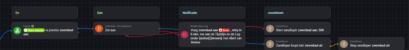

  1. i had the possibility to remove the chatty devices
  2. i checked the load on the system when it was happening.
  3. i have experirienced that if i defer the task to the device for 5 minutes, it would execute based on the defer.
  4. i use simple log to monitor this.
    here is an example set up.
  5. and the fallback
  6. this will elimate most of the issues, as you can see in the log. it will only show the retry issues, but will not show an error for the second try.
  7. in short, by setting this up, the system will not respond iminidiately but will recover a few minutes later,
is it perfect, no
does it work, yes.
