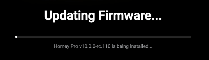

Don’t know how to see the version when the device is not setup, but it must be the newest version since I updated the firmware via USB seven times today :smile:
It’s visible on the USB Tool page - it’s visible on the page, when it offers you to do the upgrade. Is it v10.0.0-rc.110, correct ?
Yes, that is the one
