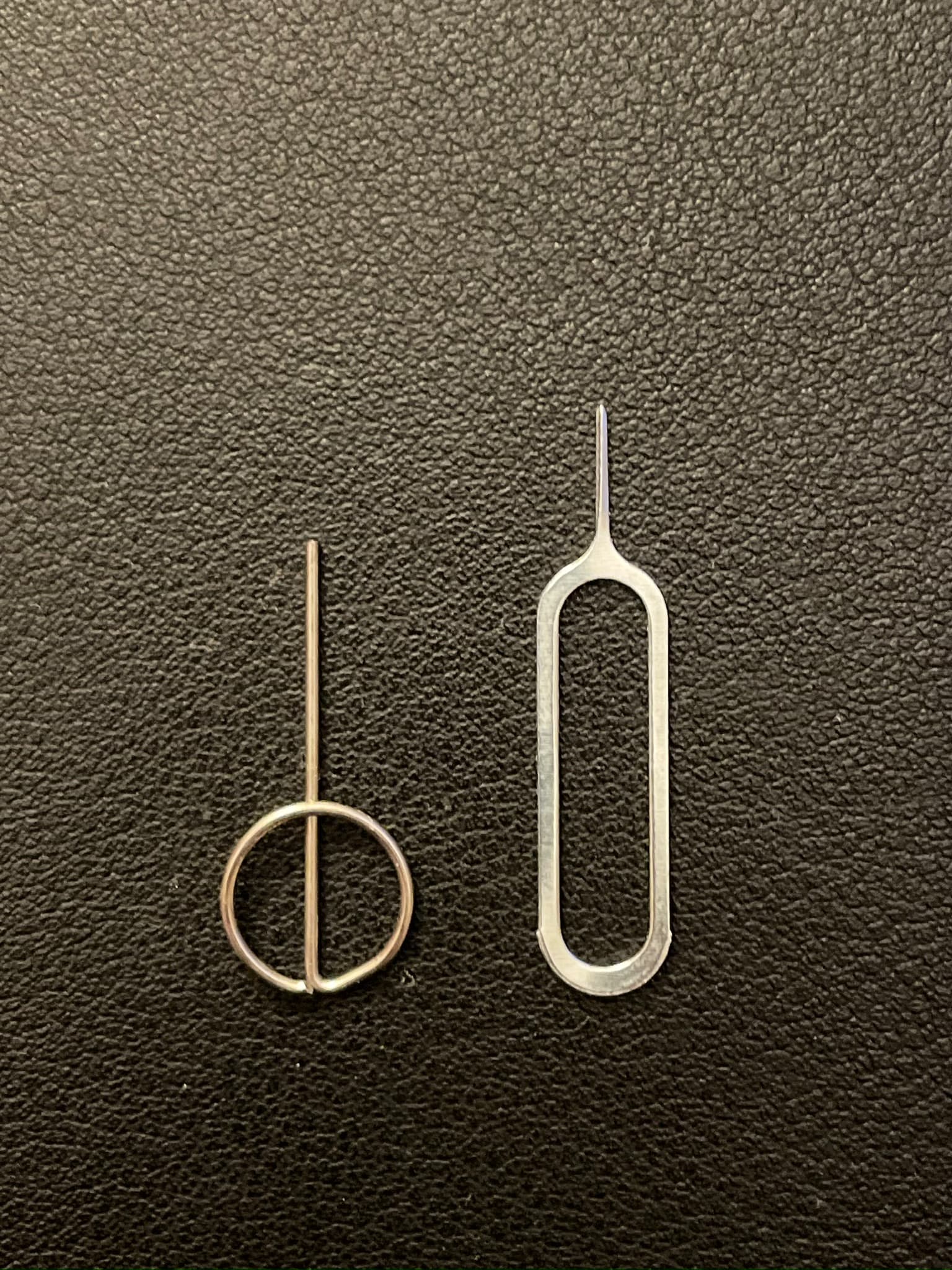

Are you sure that you’re pushing the button? The page explaining the procedure is showing a typical SIM-card push pin which isn’t long enough for Homey Pro, you need one that’s longer.
The setup page is showing the right one, which doesn’t work. The left one does:
I used a pin that was even longer, I’ve tried multiple times and I can hear and feel the button being pushed.
In that case, it sounds like a hardware issue and you need to contact Athom.
