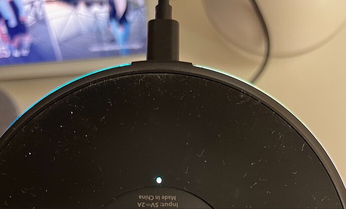

I just got my Homey Pro and i’m experiencing issues with repairing my zigbee devices. When i try to repair the device it just says that an error occured. I can add a new zigbee device just fine. I migrated a backup from my previous Homey Pro 2019. I installed RC10 after a post in the forum, but the issue still persists. So at this point i’d like to factory reset the brand new Homey, but to my surprise there’s no SIM-eject tool that’s long enough to reach the reset button (i’ve tried several). There’s also a glow coming from the reset hole, am i missing the button or does yours glow too?

And yes both have the light coming thru
The LED is strange but are you sure your pin is really long enough, eg. 10 mm and you didn’t reach microswitch, hit solid ground/LED instead ?

You have tried what exactly, 10mm and longer pin and you hit no micro-switch / no click sound ?
Thanks, the tool i was using was 7mm long. I had to use some cable insulation, i didn’t have anything else that would fit in the hole. This also fixed my issue with zigbee repairing!
