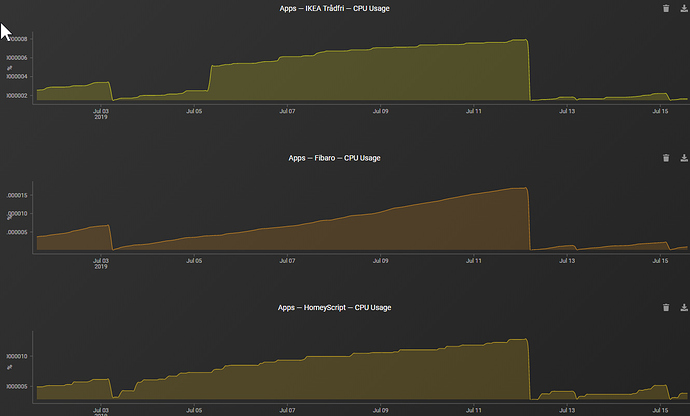

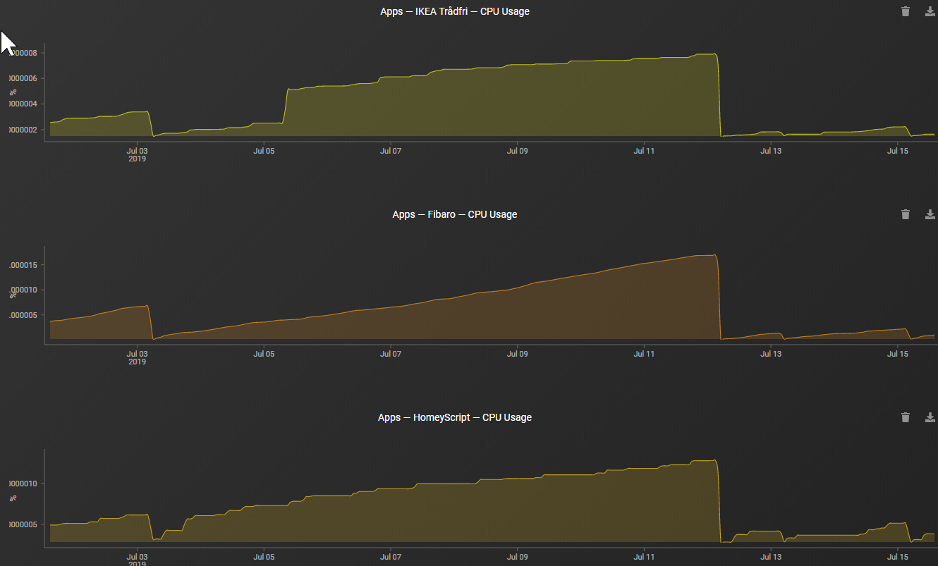

The insight page has some very strange graphs but it is difficult to understand what the graps show, but they definitely look bad (which is also why I am thinking restart might be a good idea).
But this is they way all the apps CPU graph looks o maybe they should look like this?

I also don’t know how to read the insights graph, if CPU usage is slowly increasing over time that would explain why a reboot works for some time again. I’ve heared about memory leaks, but then this would be a CPU leak :-). If processes do “hang” or threads keep executing you should see some evidence of that within the app performance monitoring.
The graph shows the “CPU time” metric, which always increases over the runtime of an app and is, therefore, not very useful. You have to specifically watch for sharp increases (like for the IKEA app on July 5th). The drops are most likely because you either restarted the app, or Homey.
IMO, Athom should have opted to graph the CPU usage, which is a percentage of available CPU capability. That way, peaks represent excessive CPU usage, and percentages are much better correlatable.
