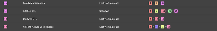

Trying to steer away from the Antenna Mod path, but I think I’m at a dead end with the Z-wave stabilisation issue. I was trawling through other posts and while i did find others who posted similar issues, there were no solutions or answers to those threads. My issue is, overnight, the default Zwave optimization algorithm goes pear shaped and i get some pretty lousy neighbours like below:
I’ve even got a Node 150 happening from time to time and it goes away (yes I’ve tried to exclude and include them again). Just by example, my node 51 is 3 meters from my Homey.
After i run a command to either turn on/off the device, or heal it, the path gets optimised (which is normally 2 hops, 3 hops after healing is done).
For those with Zwave implementations out there, please tell me I’m not the only one experiencing this? Do i potentially have a bad Homey unit? (its only 2 weeks old), or do i have bad Zwave nodes?

And do you actually have problems? Because it could just be the visual representation of homey? What I have automated is sending test signals every hour to prevent the devices from showing unreachable. Didn’t have any problems but just don’t like the nodes showing unreachable
Im starting to think it’s one or more bad nodes I have that’s causing the issue. Some zwave switches can take 10-30 seconds before responding so I think it’s Homey trying to reroute from a potential dead node (That’s what I’m theorising at the moment) but it’s all trial and error because I can’t tell which node along the way is causing grief. I just wished there was some diagnostic tool that would help determine problematic nodes, because now I need to individually exclude nodes that seem to be the issue (unless the raw logs have some meaningful data)
